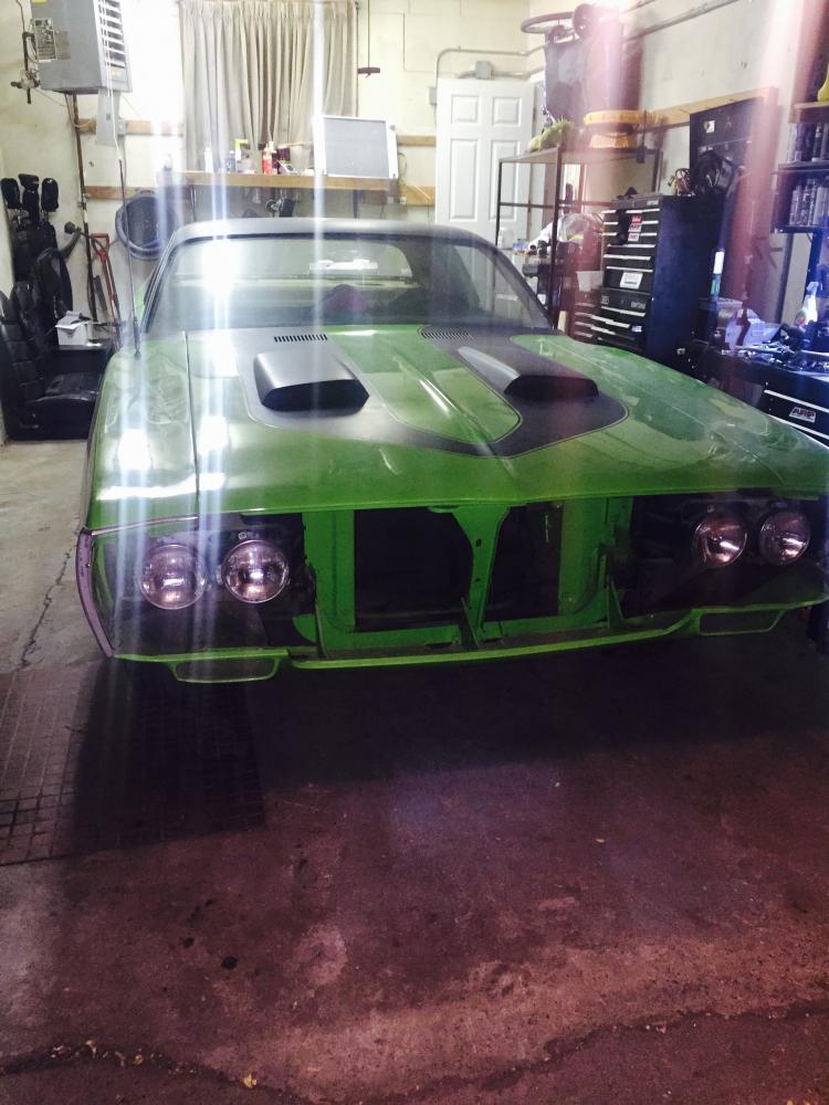

My car is sitting outside, and I only have a 1.5 car garage, I don't have room to have my motor and trans and car in the garage all at the same time so i have to get my motor and trans mounted so I can put it in my garage, I live in Edmonton Alberta lol I can have snow tomorrow. So right now with these, time is more valuable than money
you could always slide it in , mount the tailshaft on the trans mount so it wont slide around and stick a board between the oil pan and the k member. there is enough of a lip on the pan over the k member. as long as there is no exhaust system, you can put the mounts on when you get them. it does work and there is room.
if you put it in as a unit, its pretty tight because of the torsion bar mount, but it will go without tearing anything up. make sure you have the crank pulley and oil filter off

Anyways just by him being a dick it just saved me 150 or so in shipping I managed to get it all in the garage just no room image.jpg
