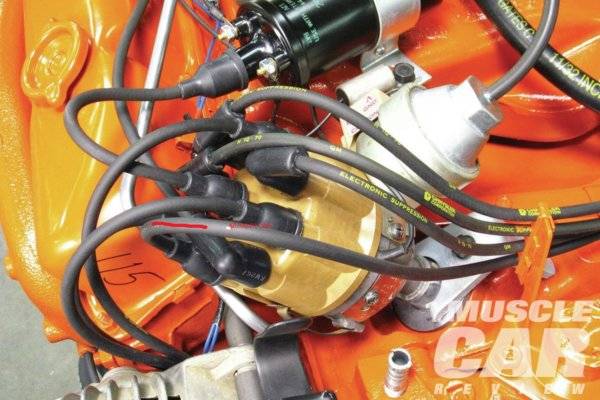

I have seen distributor VC behind fuel lines, and in front. I have seen Plug 1 wire and various locations, several cap slots different.

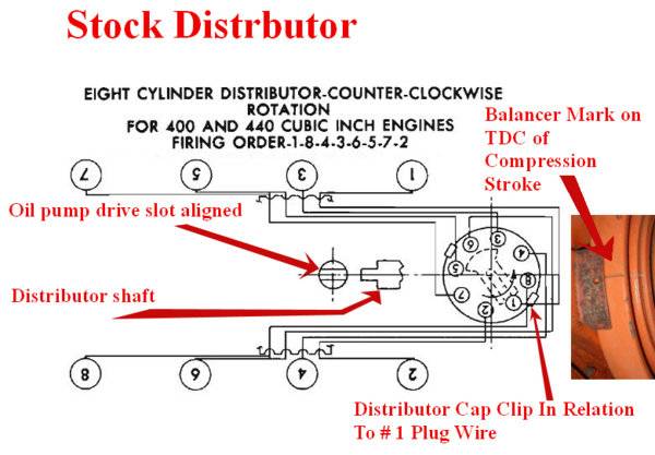

The manual does not give you a diagram for wire location on the cap. Just the firing order.
Part of the issue is that there are many variation to Prestolite DP shaft clocking (Orientation of the engagement slot on shaft), different Cam stop flat orientation which drives what direction the rotor points.
With many of these distributors being rebuilt or purchased as rebuilt back in the day you may not have original internal parts and the clocking is off.
So does anyone know what the orientation was from the Factory for the 68/69 hemi cars?

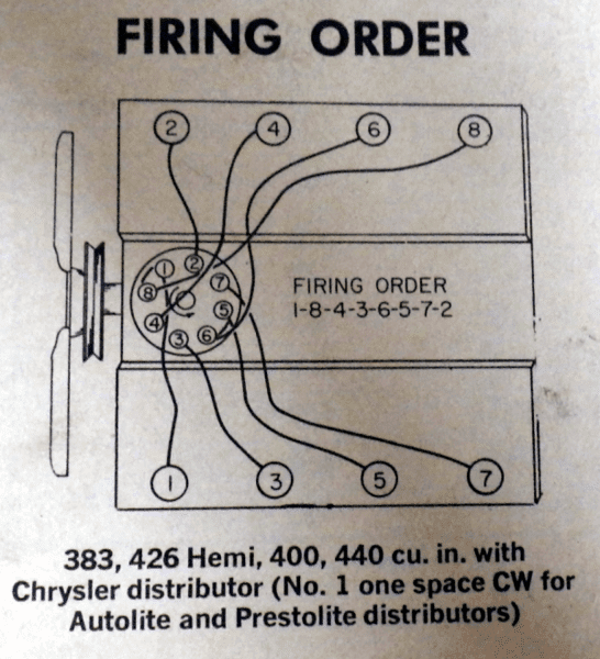

Looking at generic Motor Manuals they show that the 1 and 8 plug should straddle the fwd cap clip on Big Block engine, but no distinction made between Chrysler or Prestolite distributors.

RB plug wire number one is before the distributor cap retainer clip, away from the VC and facing the alternator. That is how I set them. Hot Rod did mopar engine detailing article that depicts this as well. I would imagine it is the same on a hemi using a presotlite versus a 440 6 using the same distributor. I have attached a picture and while I do realize its not a hemi and not a prestolite dist, I am pretty sure its the same routing.
It is the same.....Number one on a BB is the same position for ALL distributors
Thanks and that is how the Motor Reference books show it. Before the clip. The clip on Chrysler distributor are in a different position though. Further clockwise because vc is used as notch for the Chry cap. Prestolite cap and clip position is different.

Number one position if distributor is installed properly is where it is an always before the clip...unless the installer or builder sucks...

Number one position if distributor is installed properly is where it is an always before the clip...unless the installer or builder sucks...[/QU

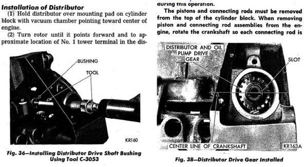

And the distributor drive gear not installed with the slot not parallel to the block centerline.
Like dieseldazzle said, rotate the oil pump drive to get your desired positioning. The main reasons for a suggested position was clearance and to accommodate pre-manufactured spark plug wire lengths.

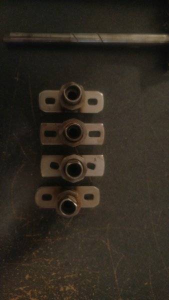

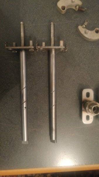

So for those of you that really do not now the variations on Prestolite parts here are 2 pictures. Notice the 2 RB distributor shafts, one is NOS not yet drilled for the collar pin. See how the tip is at a different angle. Because of that the Cam Stop will orient differently if dropped in the same horizontal slot on the distributor gear.
Now look at the Cam stops, all are for Prestolite caps and rotors not Chrysler ones. See the flat at various angles. Again this forces the rotor to point in a different direction. So if someone mixed and matched different parts to salvage a ""hemi" Distributor it could be done but the position of the rotor when #1 is at TDC would be different.
I can also help school you on Chrysler shafts and cam stops, much more universal though. When I work distributors I literally am working a dozen at a time. So I can see and measure differences. For example presotolite IBP-1 bodies have different lengths that drive different length shafts. The mounting face to tip is the same big block length, but the shafts are 3/8" longer which is significant considering the limited engagement depth of the tip. The reason is the bearing to bearing length varied over the years.

Top picture third cam down is for a 64/65/68 race hemi with transistorized ignition and NO vacuum advance. I bought one of those in 1971.
Thanks Fran, the second one down is stamped B and that is what is in my hemi distributor, but I do not know if that is correct for hemi or if it was a 440 one. Also not sure what early non cap cars had. Should be different since non cap had 10deg initial timing and less mechanical and CAP cars had zero initial and more mechanical adv.
