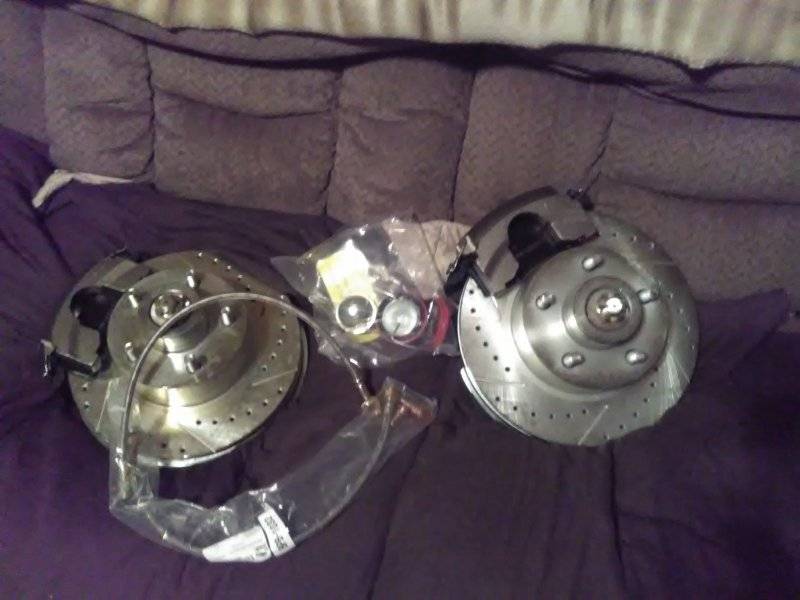

it came with new spindles and everything. ya can get them in a 2 in drop if ya want. i got them from P.O.L. under 800 including shipping from CA.@hacksaw , is that for your 62? Using the stock drum spindles? Who from? (I've been looking at the leeds kit, looks like it has everything but the linelock).
