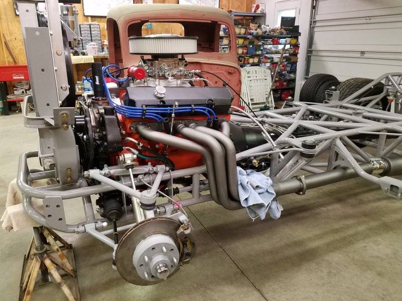

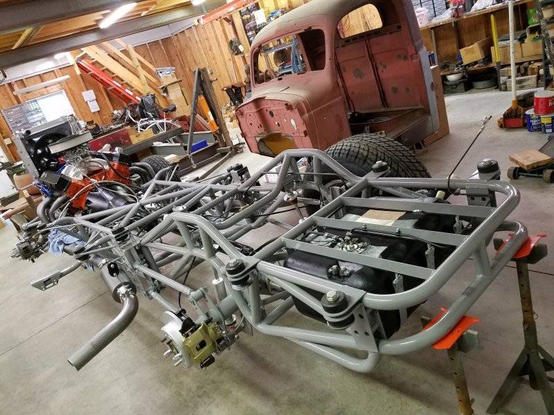

Notice the difference in size and type of disc
front to rear.
These were run thru a computer simulation
to determine brake fade and failure rates on
a vehicle weighing in at 3300 lbs curb weight.
I'm in agreement that just from observation,
those front discs are wholly inadequate.
