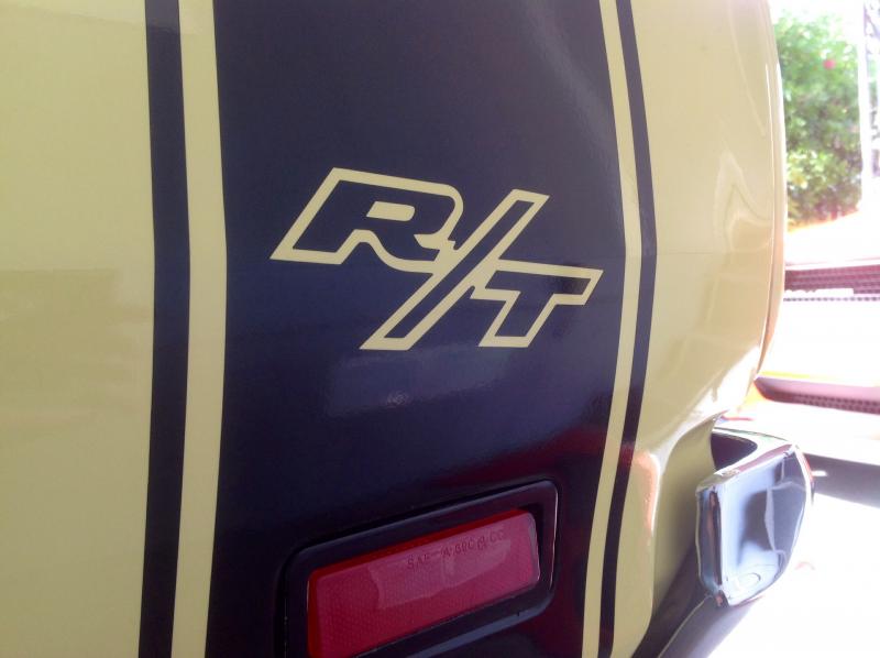

image.jpgGood thread. Just a note on stripe sourcing, I got the R/T bumblebee stripe years ago from Year One. It came in a quality 3M package. However, the R/T cut-out is crooked. Had to adjust and it was difficult to line up with the side reflector etc. Stripe quality is good, may just have been an isolated bad cut. Noticed years after purchase.

View attachment 270242Good thread. Just a note on stripe sourcing, I got the R/T bumblebee stripe years ago from Year One. It came in a quality 3M package. However, the R/T cut-out is crooked. Had to adjust and it was difficult to line up with the side reflector etc. Stripe quality is good, may just have been an isolated bad cut. Noticed years after purchase.

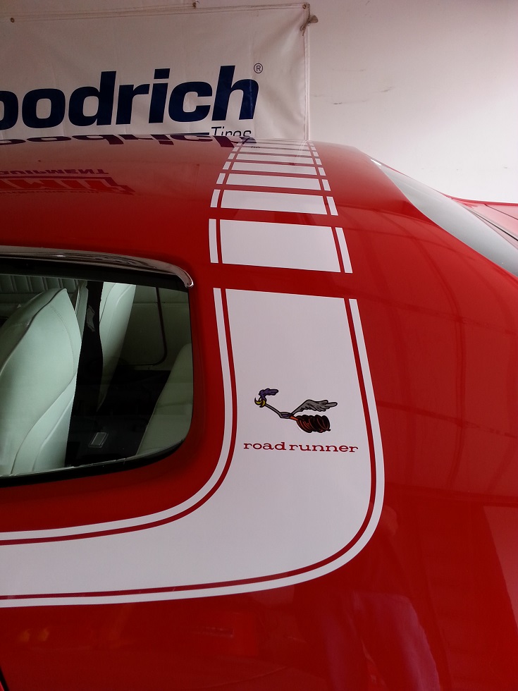

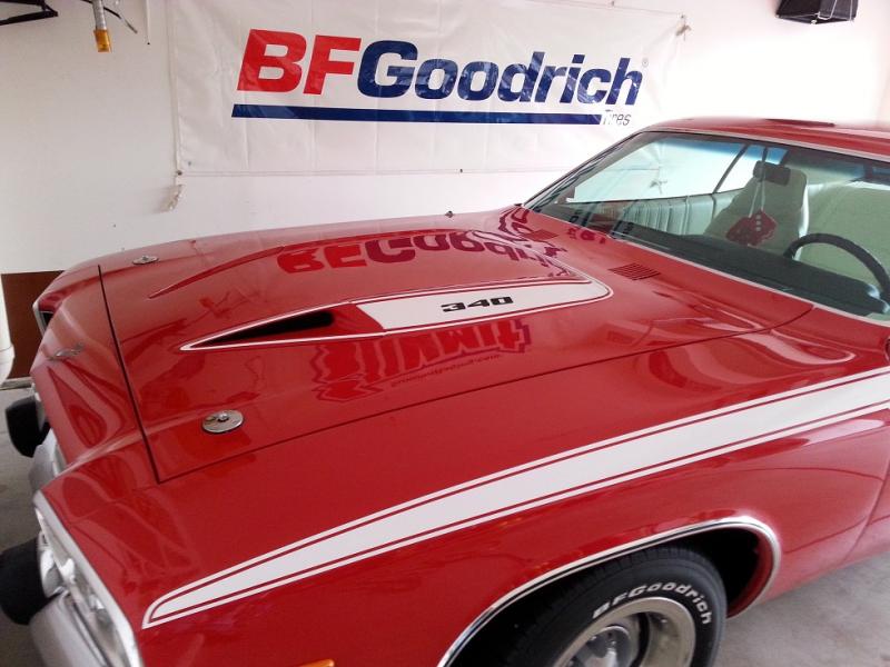

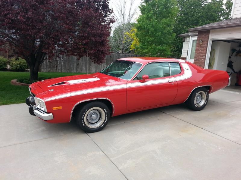

Anyway, rigogarcia, here is a picture of my 73 RR and stripes! Very happy with them.
