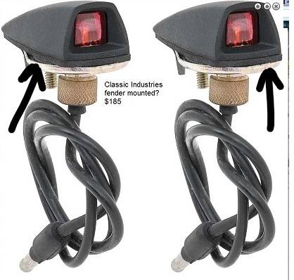

Did not know these fender turn signals were being reproduced.
Different vendors. Factory ones did not have that plate.
Those plates are factory and on every NOS set I have and every original set I have.

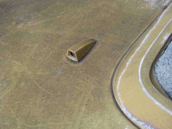

They are nearly identical to the original units I have mounted on the hood of my 72 Runner. The lights and wiring of my originals were missing so these seem correct, or close enough. The connectors seem correct as I found my original bullet type connectors bundled up on the firewall.

Tommyg29 you should have those factory plates under those signals. The wiring should not just screw into the lens as you have shown...

My fender tag has the L31 code for hood/fender mounted signals and Im pretty sure its the original hood.
Keep in mind that mine are in the hood but I think they are identical to the fender mounted units, although Mopar did make quite a few different types for different years and models.

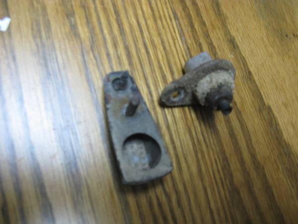

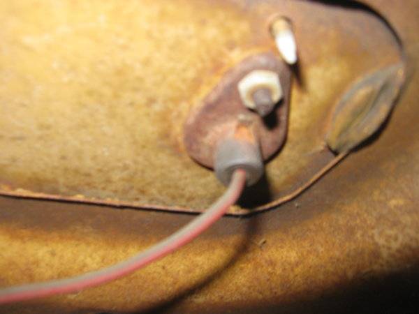

Yes they should be as you are correct it's what holds the bulb up inside the lens. Here are pics of an original hood with turn signals showing the original plates. There is also a foam gasket on the other side of the plate.

Yes from factory those chrome signals shown are 71-2 Dodge B-body(and others) and the painted style shown are 71-2 Plymouth B-body(and others).

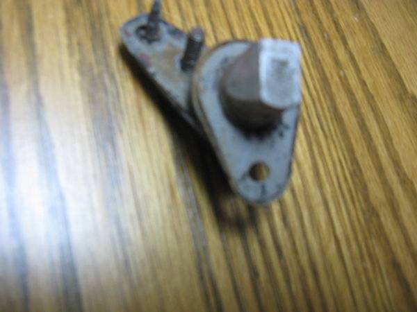

There are 3 gaskets. Not the best pics but there is a paper gasket goes under the turn signal housing/cover stays on topside. Then the gasket is on the top of the "plate" and goes up. Then there is a white circle foam gasket around the wiring on bottom of plate to prevent corrosion at socket/bulb connection...

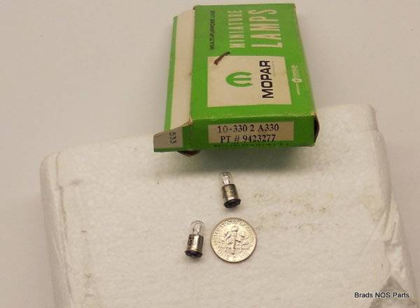

330 as far I recall. Don't get it from ebay unless you wanna pay 500% to 1000% ( or more ) more than its price. Get them from any regular local shop or if the web, bulbtown is a good option

Ticks me off that for $185 I dont get two 50 cent bulbs with them
Wow That's cheap should come with them... Anyway just so you know what the 330 bulbs look like taken from Brad's nos...
