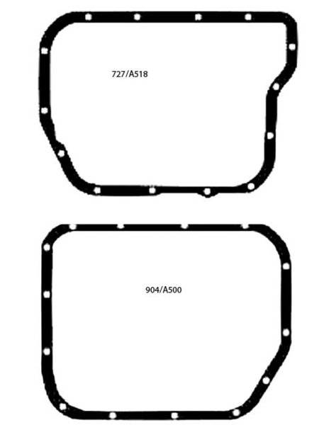

You have a 904. A 727 will not mate to a 318 from what I understand. The 904 pan is shaped like the bottom one in the picture. On driver side of the transmission, down by the linkage. It will have A-904 in huge letters. You can’t miss it and confuse one for the other if you’re looking at the tranny from down under. The 904 was considered a light duty tranny. That’s why all the 318 automatic models received 904 transmissions. Smaller engine, lighter duty tranny.

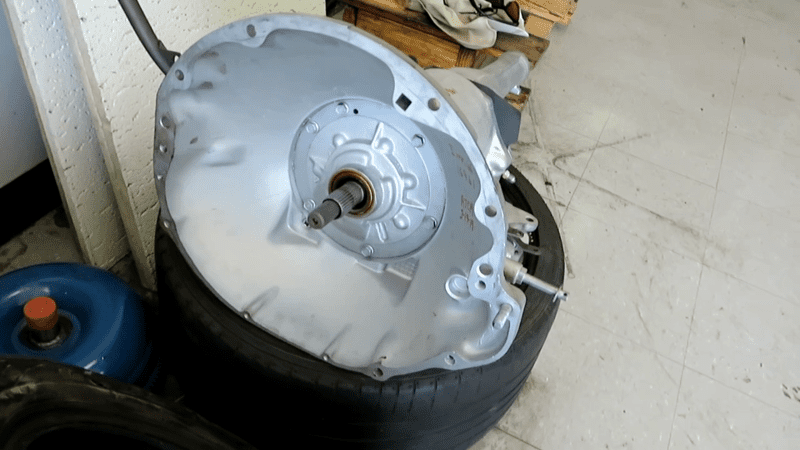

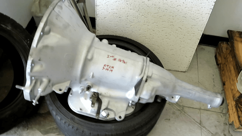

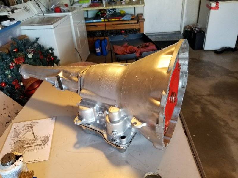

Ok, I got pictures. According to what you all have told me, this is a 904. Anyone disagree? Bye the way, thank you all for the information you have provided!

I went to visit my Coronet this last weekend. It is sitting in a storage unit until May 4th when it will be trailered to the body/paint shop. I checked the fender tag while I was there and it says D31. Between that and the shape of the pan, we have identified this as the 904 transmission which is correct for this car. I have learned a lot from you all on this thread (and others as well). Just wanted to say thanks again!!!
