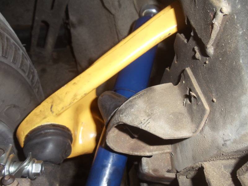

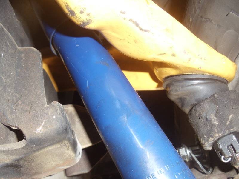

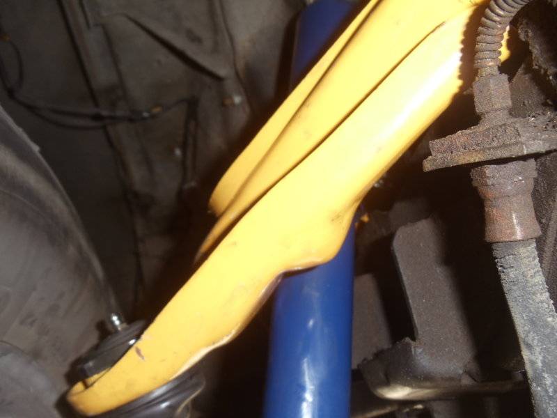

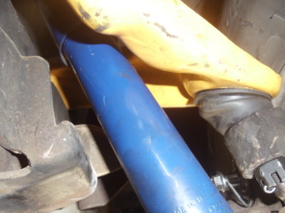

Look at the fotos and tell me it isn't so. The upper bump stop looks like it is going to hit in the wrong place:

Yes those are installed either upside down or they installed the left one on the right side and flipped it over. Had the same thing happen to me with a local shop. After driving only 5 miles I heard something and part of the UCA got gouged. Now I research and double check all shop done work upon completion. Good catch on your part!
IDIOTS! Did they align it also? Impossible to get that right with the arms on the wrong side.
The correct installation is almost self explanatory if you spend minute and look at the suspension, Drunk? Tired? In a hurry? No excuse, how many other jobs are fubar at this place?
That’s very hard on the upper ball joint, look at the angle.
Was this a shop or a backyard guy? Never go back there regardless. That guy should be cleaning bathrooms instead of wrenching.
It is not possible to install them upside down but it sure is possible for someone to have them on the wrong side.
A guy I know....He is actually a genuine "Rocket Scientist" (Aerospace Engineer) Had his car on jackstands at his place when I went over to buy an intake manifold. There sat a 70 HEMI Challenger of his, he was just finishing up with the front end rebuild. His UCAs were on the wrong side. He seemed insulted when I told him.
The ball joint top is supposed to sit level when the UCAs are installed right. The forward UCA mount sits about 1 1/4" higher than the rear mount as part of the "Anti-Dive". Because of this, the outer tip of the UCA and ball joint threads and mount are tilted to sit nearly level. When they are installed backwards, the tops of the ball joints are severely angled to the point of danger. I would not drive far or stress the suspension un til they are swapped back to the correct positions.
3rd picture look at shock the flat area looks like where the bumper should hit.

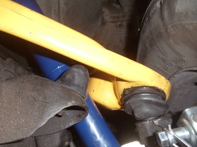

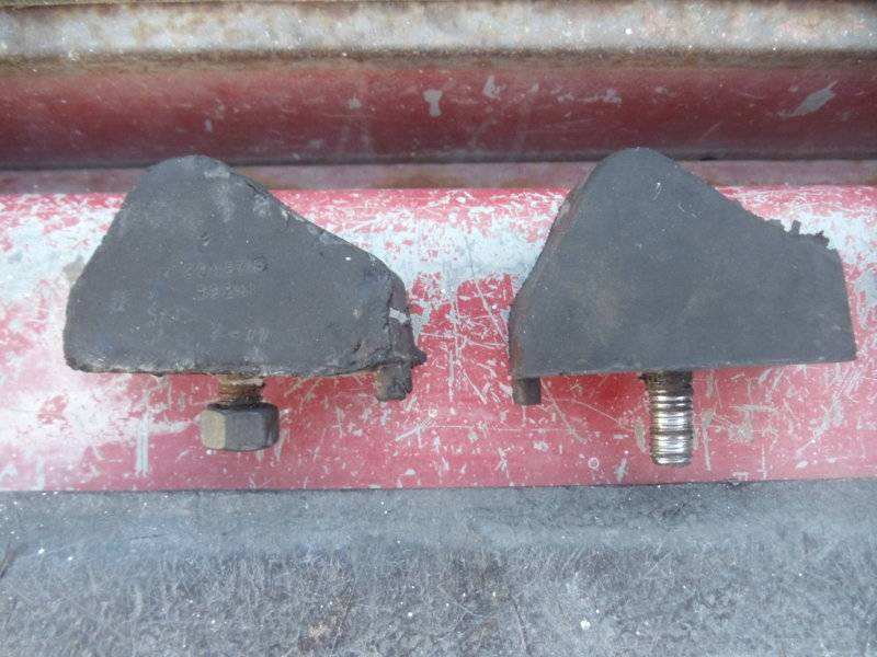

We switched the upper control arms side to side, now that's better.
BUT ...

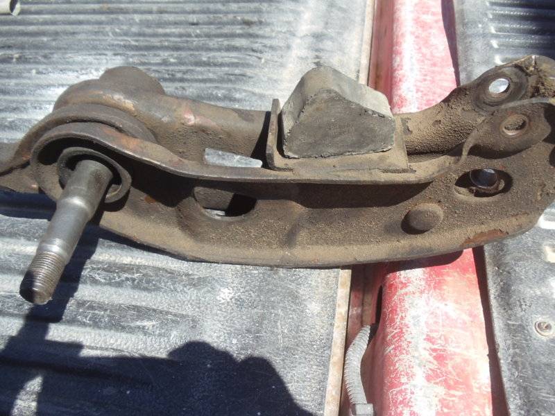

In the meantime, another problem arose, the rubber bumpers on the lower control arms appeared to be on wrong. There is a gentle slope on one side of the bumper, and a sharper slope on the other. But the new bumpers were installed with the locating lug in the correct hole. So what could possibly be wrong? I took a foto of the original bumper still installed so I was sure something was up (first foto).
We removed both of the new bumpers to find the locating lugs were manufactured on the wrong end. Factory bumper on the left and "new" bumper on the right (second foto). Communist China again?
Going to have to reinstall the old factory correct bumpers!

I have never noticed the lower bumpstops to have a dowel on the bottom, only the threaded 3/8" mounting stud.
regardless, I would expect the steeper sloped side to be toward the engine as shown in the picture of the LCA.
BUT ...

Is there a right and a left on these?
The rubber bumpers are built both the same. When installed, the locating pins go toward the outside of the lower control arms so they match up with the bump area correctly and so they fall in the factory holes that they fit into.
