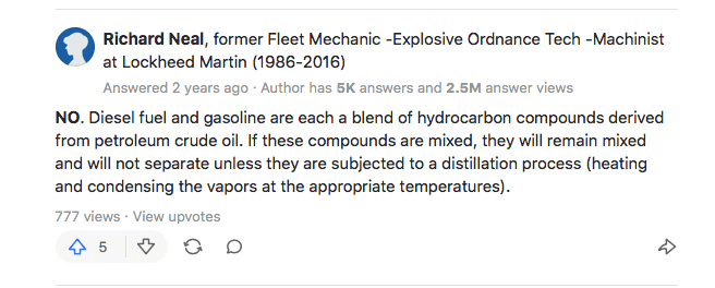

Bull crap. Diesel fuel and gasoline are each a blend of hydrocarbon compounds derived from petroleum crude oil. If these compounds are mixed, they will remain mixed and will not separate unless they are subjected to a distillation process (heating and condensing the vapors at the appropriate temperatures
And if your trying to impress us with how smart you are... I can cut & paste too... But I try to make a point of crediting my source... I mean you even kept the quote about heating & cooling vapors....
I can't honestly say it was a quart or two quarts... It wasn't much... You could see it floating in the gasoline, they didn't mix, it was pretty obvious what was diesel & what was gasoline... And you could smell the diesel over the gas fumes....
I just found a simple explanation. So quit crying just because you got busted. You just got a taste of your own medicine.
My own medicine? Really? I spent time trying to help people & you see that as somehow bad? Your screwed up...
I already admitted that your were correct about fuel & gas mixing but with the stipulation there was definitely something that didn't mix.. End of the day the important take should be drain the fuel, flush the system & replace the fuel filter... And hope the guy gets lucky...
Explain how I screwed up. I also spend time trying to help people. In the past you have made jabs at my comments. So get over it. I am.
