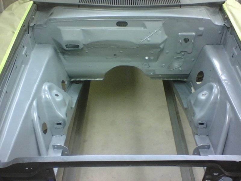

Malex, on the Dart split the front of the 1/4 right on the outer corner of the wheel lip. Make a 2nd cut 1" forward at the bottom and carefully blend back to zero about 8" up. I used a french curve fro the art store. Then you just push the lip forward and end up welding on the corner of the wheel lip. Very little body work. Granted the inner needs to be split and rewelded also. With a nice curve it's undetectable. You'll be happier when you try to fit a 28-29' tire. Bearman, The firewall really moves back easy on a B-Body if you want to get aggressive with engine set back. A 2x4 on the fire wall, bottle jack with an extension on the K-frame. It does kink the firewall but its an easy fix. If it were e I'd cut the tunnel as well. Compare this pic to your firewall. This is before body work.
DougView attachment 677541

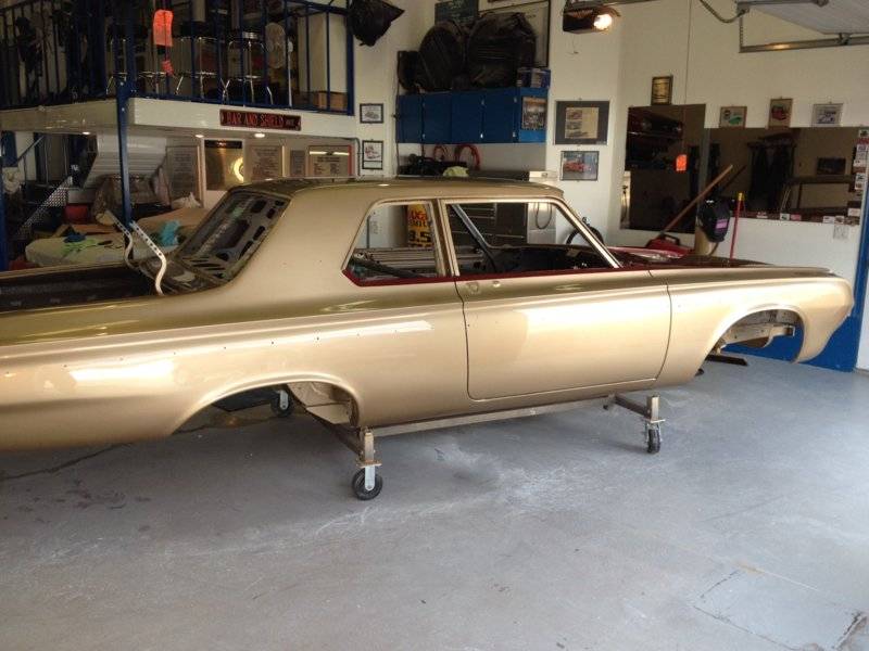

When I did my 64 at the front of the lip I went straight up with my cut, then a 90 and cut back to the centre of the wheel well about an inch over the wheel arch. Slid the piece ahead about an inch and a bit, then fab'd and welded a small piece to fit in the gap. The stretched opening is sort of noticeable and the lip is welded to the flat of the tub at the front.
Now the problem I'm struggling with on the Dart is, do I stretch or do I raise them as well. My intention at this point is to make the Superstock look. I'm not worried about them turning out good. But cutting new AMD quarters is like cutting my arm off. So that is the 2nd biggest decision. The first / worst decision is colour.... again.
Perhaps I had better take a FBBO survey on this A body. To cut or not to cut.. I like this look and it has been the plan.
