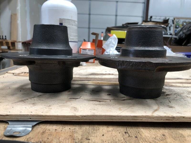

The 11" are spaced out about .250" farther from the brake backing plate

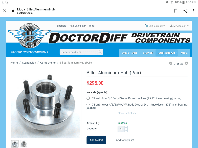

Dr. Diff has these.
Yeah, I had seen those as well, but that's way more than I feel like paying if I can get away with something else.

Here’s a pic of a 10” (left) and 11” (right) hub.
