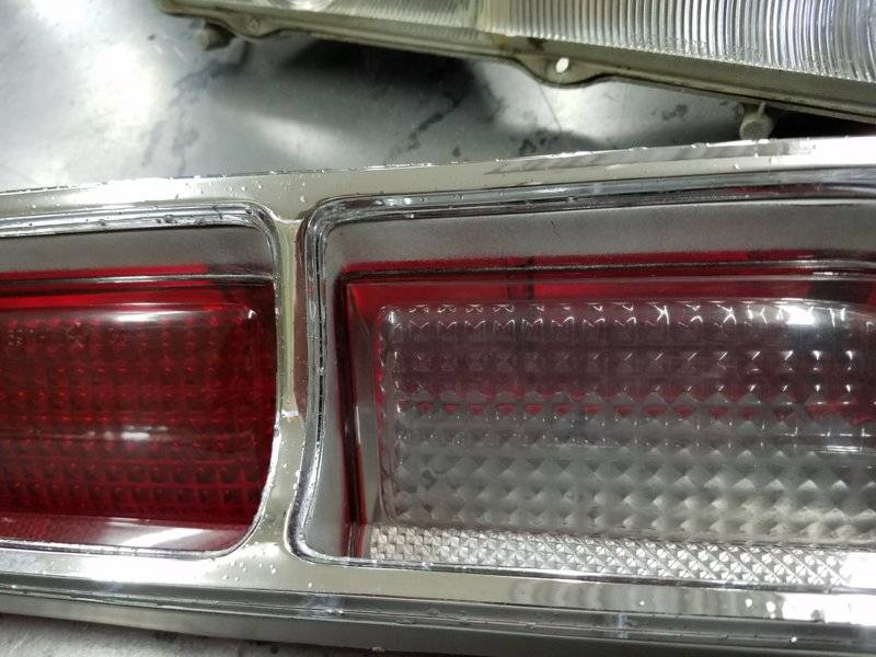

And since we are on the subject. Does anybody know of a supplier for just the plastic chrome trim. Everything else is in great condition except for pitting chrome.

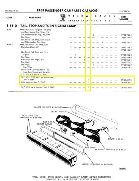

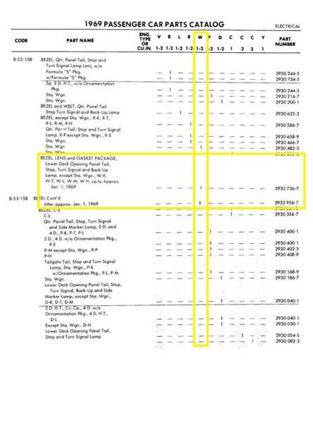

It was a January 1, 1969 switch over for the housing and lens. Parts manual pages below.

And since we are on the subject. Does anybody know of a supplier for just the plastic chrome trim. Everything else is in great condition except for pitting chrome.View attachment 821772
The bezel is pot metal. No one reproduces this piece, they have to be re-chromed. The Chrome Shop out of Menasha does mine. Brace yourself, not cheap. Talk to Steve there.
D
D

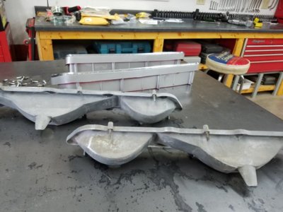

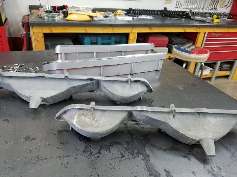

How does a guy get it off without ruining the mounting studs? Looks almost like they are melted with an iron.
