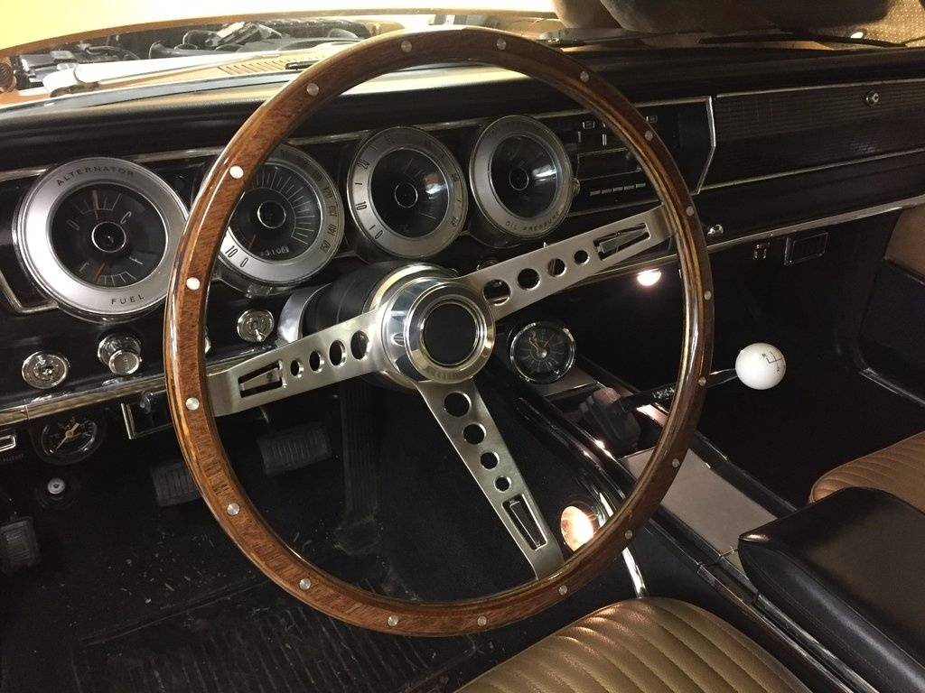

I have a non stock Hurst shifter in my charger, I did not install it so I don't know much about it. It is easy to hit reverse but getting tougher to get out and sometimes takes all my effort. I'm worried now I'm doing damage as I know the stock shifter has that release lever. Any ideas how to prevent damage bar changing it back to stock?

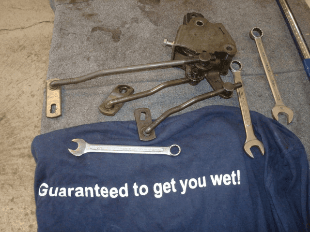

Can the stock shifter with the reverse release lever on the shifter be just bypassed by fitting a hurst arm or would the whole linkage as shown in that lovely photo have been upgrade/replaced? Just trying to guess what the last guy did before I get under with my new alignment knowledge and 1/4 inch bolt.
Sorry, I am only familiar with the stock shifter mechanisms.
