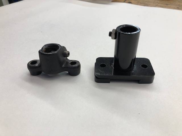

Several people with isolated steering column 73s and some 74s have approached regarding steering box kits. The column I am referring to has the rubber donut close to the coupler that joins the column to the box. Please see the attached photo of the new coupling. I have not added this to the site just yet, but its eligible for the current promo code lowering the kit cost to 755 + shipping. This is an easy installation and even uses your existing original hardware. PM, call or email if interested in ordering.
No cutting of column shaft?
Zero. This part replaces the cast part that goes from the bottom of the rubber donut to the steering box.

The new coupling is 105 by itself, 95 with the complete kit.
I posted the photo to show the part it replaces during the installation.

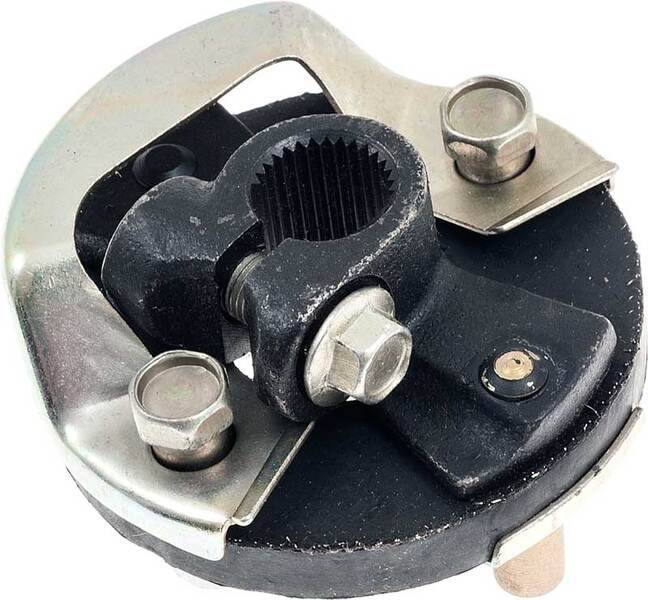

ok, as far I can see it replaces the stock spline coupler and by the height I can say it takes also the thickness of the rag joint to attach straight to the stock coupler?
OR... maybe could be made to use a regular universal fit rag joint coupler just like 74s are instead the thick puck kind ?
( sample pic, not Mopar specific )
Would be nicer be able to still enjoy the isolation system but just like 74s are, using something like you did, to take the extra 73 rag joint thickness but able to attach the 74 and lates kind ( and most of cars around ). Just my 2 cents.
