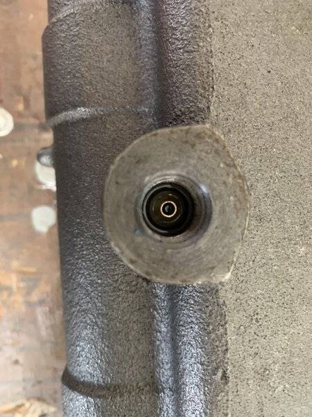

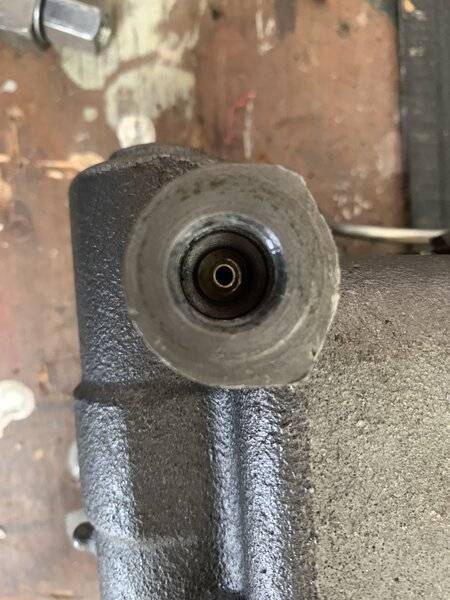

It was part of the kit I bought. It’s a cast iron 15/16 bore View attachment 1105014

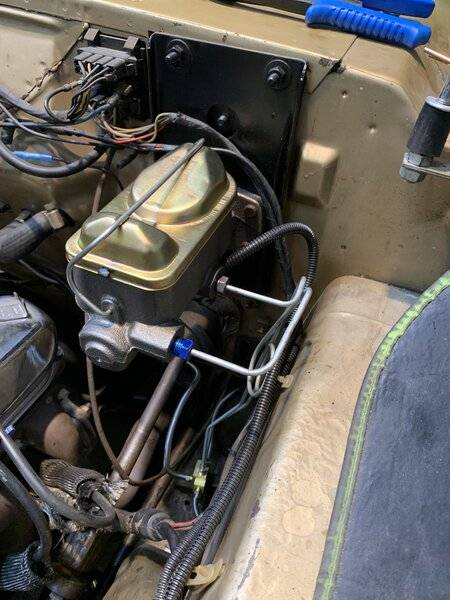

Another I have to ask...You do have the front brake line hooked to the large reservoir? (Not easy to do with most master cylinders having two different size fittings but you never know).

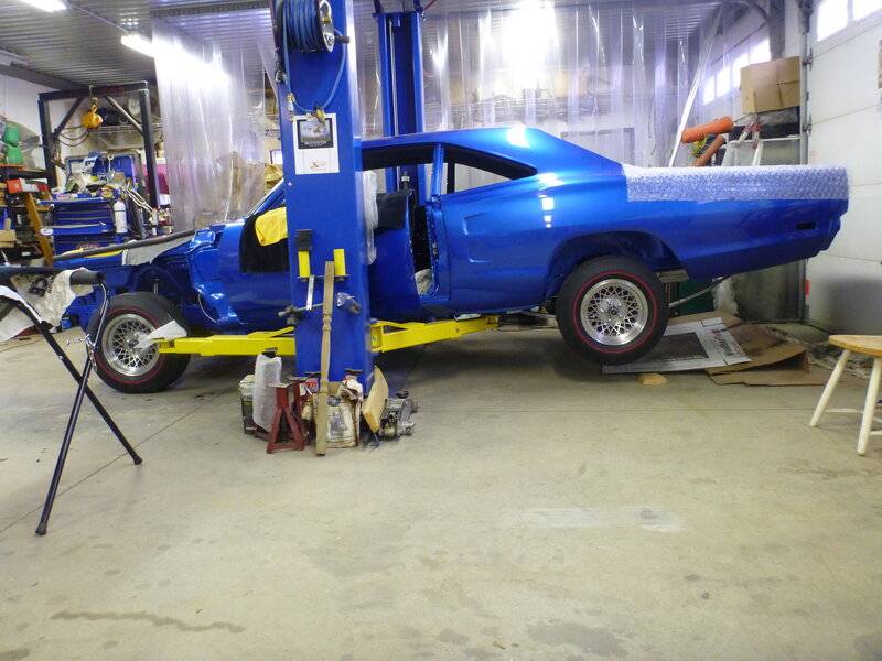

Sounds like you've done this a time or two. :poke:
Here, let me help you with that response...
"Although the front lifting arms aren't being used here, I only used the lift far enough to slightly raise
the rear of the car without the rest of the car touching the lift anywhere else - or sliding off the rear
lifting arms."
lifting arms."
Mechanics do it all the time. As long as the other wheels are touching the ground, no harm, no foul.
