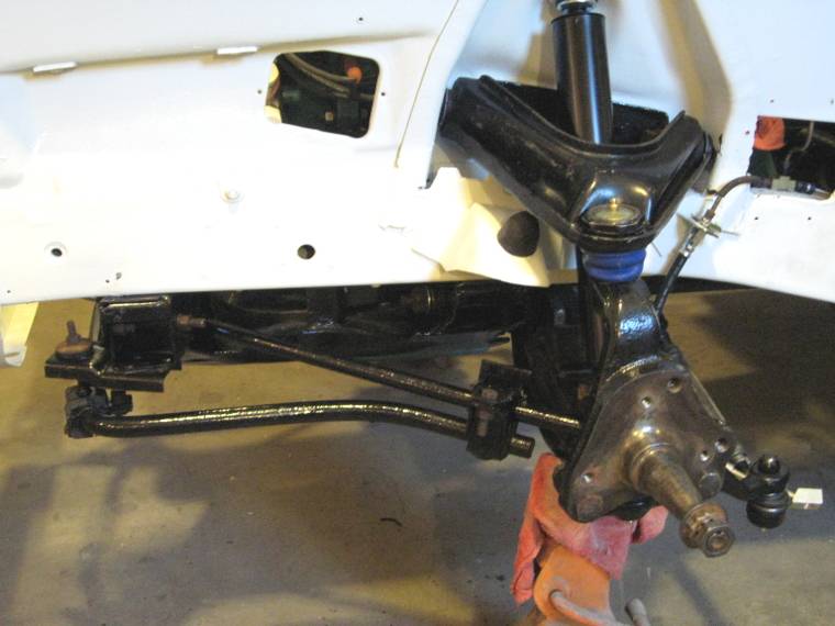

75 Dart caliper brackets. There are two different rotor sizes used on the "A" bodies, 11.75" and 10.87" and the brackets are different sizes depending on which size rotors they're designed for. Both bolt to the "A" body spindles as does the original steering knuckle.
This is the "A" body spindle with the original '64 steering knuckle bolted on ready for the caliper brackets, calipers and rotors. The original front sway bar is installed as well.
The "A" body disks originally mounted on the front side of the spindle but when this sway bar is used you need to move the caliper to the rear side. Very easy to do as all that's required is switching the spindles side for side and it does not change the steering geometry.

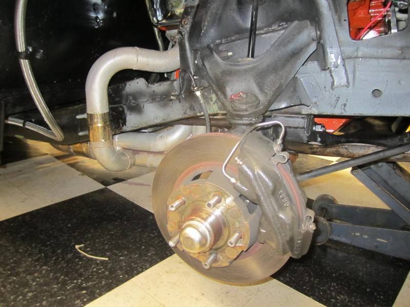

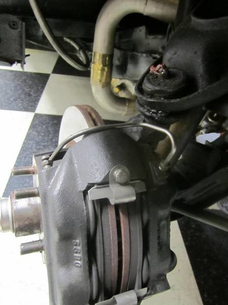

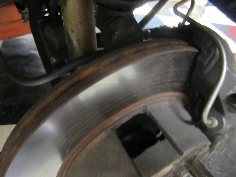

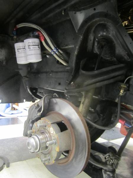

I went with the SSBC basic kit,manual disc.It bolted right on to my 63 spindles. I also wanted something that would stop me when I had the chance to go to the track.So far they have performed fantanstic with no problem stopping at the track from almost 150 mph.I can tell I will have to install rear disc soon as my speed will increase this year to upward of 160mph.

View attachment 587874 View attachment 587875 View attachment 587876 View attachment 587877
