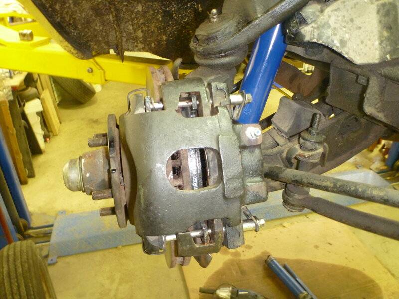

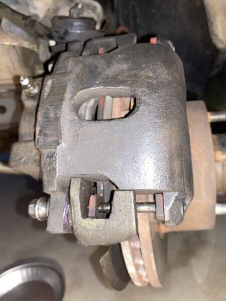

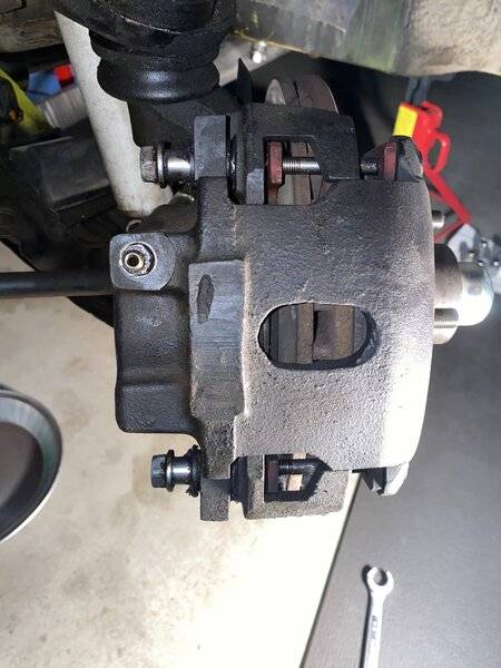

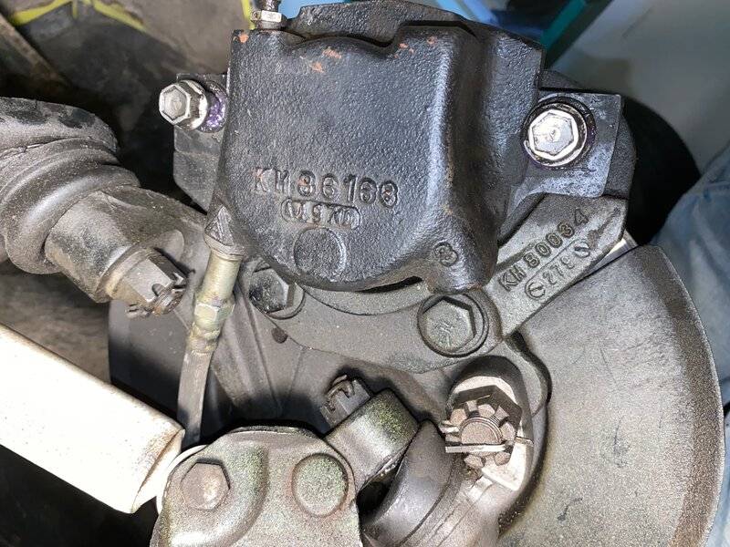

My car has Single Piston Floating Calipers up front. When I went to remove the calipers, I discovered the positioners and anti-rattle spring were missing from both calipers.

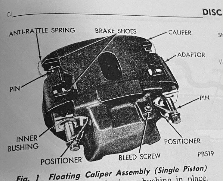

Service manual shows these parts installed. Do you guys have these “positioners” and the anti-rattle springs on your factory calipers? Where can the positioners be obtained from?

I have neither part on my setup. Seems to work fine. Switched to discs in 1982.
Mike
Don’t have either part on my pin type calipers. No rattles or squeaks.

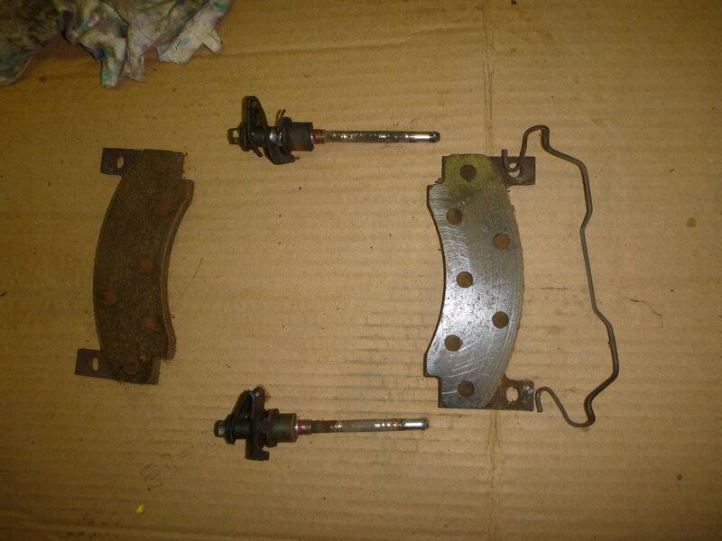

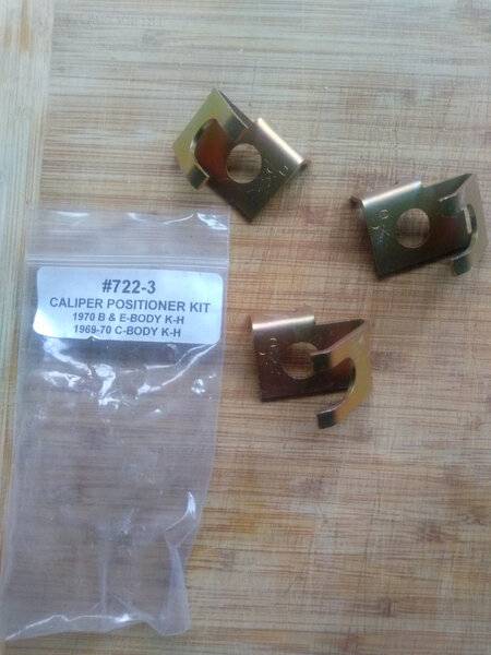

I have them on my brakes. Noticed one was broke so I replaced the one. Made no difference to me either. I got them from Brewer's Performance. Search the part number/name in the pic.

The factory did away with the positioners in later years. Your pins look like the later, shorter ones that didn't use them. Either way, don't bother with them, in my opinion.
I got a repro set of parts from Jamie at Mega Parts if you want them.
Think I read in Mopar Action Dico Tech or Stop & Swap that they stop caliper from rattling.

I got new pins and bushes, positioners and anti-rattle springs.
