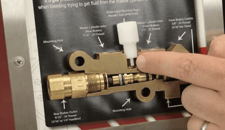

Looks like my existing after-market setup is an all-in one combination valve like this Summit Racing tech explanation shows:
What is a brake combination valve?
Or I can order the 2-piece setup like this? They describe the lower piece as the metering valve portion (different than proportioning valve).

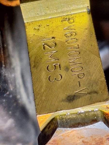

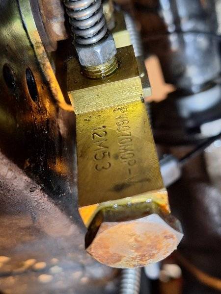

Hey Dwayne, found your thread during a search. While we were installing the TKX, Greg noticed some brake fluid weeping from the front right-hand side flex line. While under the car this weekend I found the distribution block was leaking from the bottom, much like you posted. It's a fairly new unit, replaced in 2014 when I converted to front disc brakes.
I found the original receipt: I bought the entire disc brake kit and dist block from Cass at Dr. Diff; the parts were from The Right Stuff. Looks like the same one you posted on #8.
You can see tiny spots of fluid where the bolt head meets the block.
I suspect the fittings on the lines. The ones from my master cylinder are originals from a 73-76 front disc A body car so they are maybe 50 years old. The threads do get worn after multiple on/off sessions.
If your fittings are "seasoned", your problem may lie there.
View attachment 1592578View attachment 1592579
It looks like the line has fluid on the tube nut threads. I would double check that first before blaming the valve. A minute leak may take a long time to make a drop. I would clean it and blow it off well and look every day to be sure. . Remember a leak does not drip from the top.
