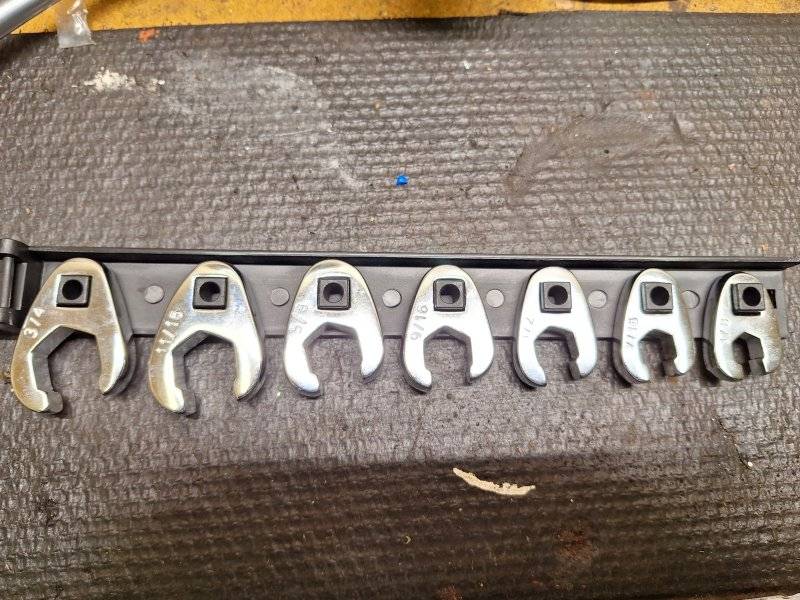

BTW, last week I picked up this set of crow's feet flare nut wrenches. They were a game changer, as regular wrenches wouldn't have fit with the headers right next to the distribution block.
