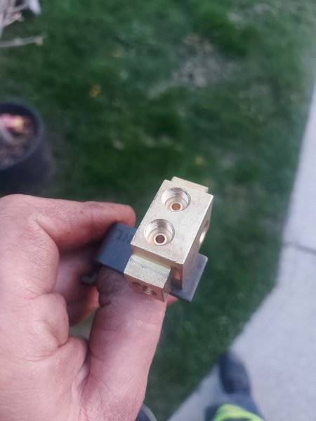

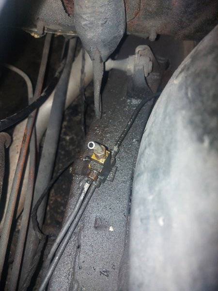

Distribution block. Working on a single bowl master swap and this is what they send me. I have a 65 Savoy which i thought was the same as a Fury . Hm

Well, for 65, the Fury name was moved over to the C body and the B body became the Belvedere/Satellite.
Are you just swapping master cylinders or are you upgrading to a 'dual pot' master cylinder?
Just upgrading and keeping the 4 drums for now. The other was leaking and the guy had wrong one on there .
