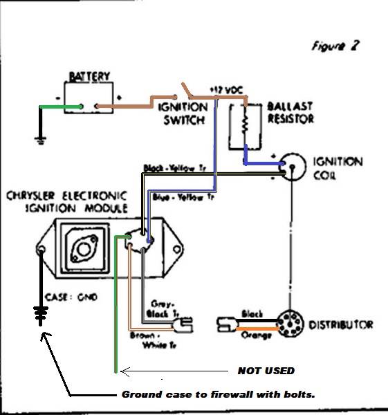

I know what color all of the wires are. What I was saying is the wiring diagram should have the wire colors labeled on it for those that not aware.
Like a road map with unnamed streets. Almost Useless.
The secondary resistor you noted, was eliminated BY A CIRCUIT RE-DESIGN, AND NOT MOVED TO THE ECU INTERIOR and several of the sensing circuit's (dwell or coil's charging time base network) increased to accomodate. Perhaps you should consider learning about how the internal components operate b4 offering an invalid opinion. GROUNDING IS FUNDAMENTAL AND HAS BEEN REITERATED HUNDREDS OF TIMES prior to this point.

THANK YOU.....I APPRECIATE THE HELP.....I've disassembled both the origional and present day ECU's...there is a significant difference in both components used and the circuit design. One of the most important revisions was the switching transistor on the outside of the case; it was changed to a power Darlington transistor, similar to an IGBT (Insulated Gate Bi-polar Transistor) device, with internal transient supression and an accelerator diode built in.
Here ya go I edited the first few with my crayons.
Well, I have opened several ECUs and everyone is way diff from the other, and one diff I found is some get a ballast resistor attached to the PCB on 4 pins, which 5 pins don't have. Of course that requires a new redesing of the system. That's too obvious.
