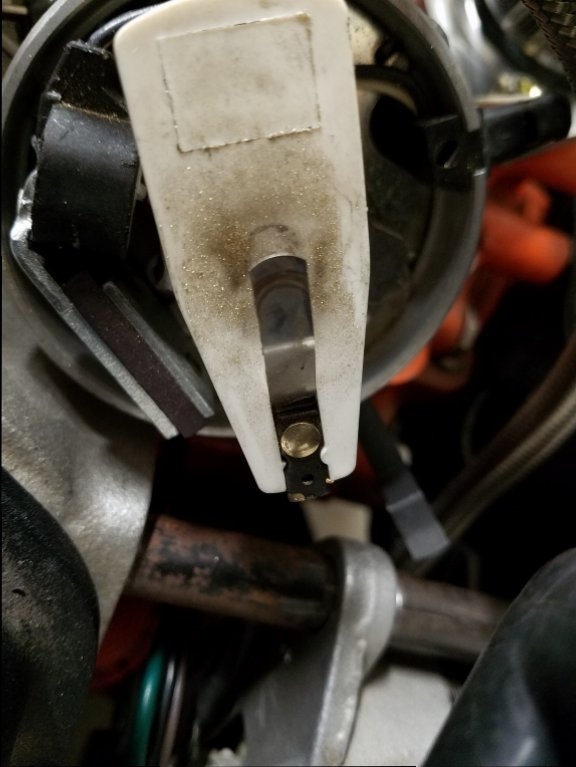

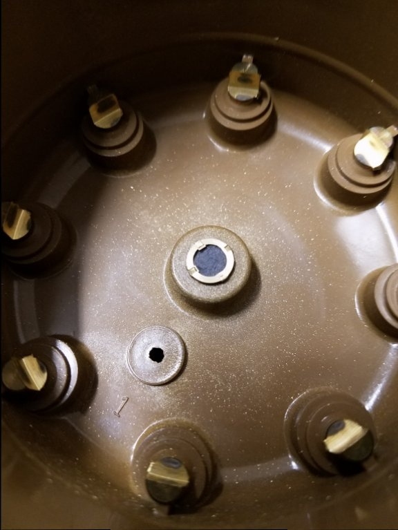

Hi guys, just popped off my cap and took a look...I'm not sure if what I see is okay or a sign of something, so I thought I'd run it by ya....lots of sparkly stuff in there and some carbon around the rotor but maybe that's normal? Very new MP parts BTW,thanks for any input!
Dame those new MP parts. Get a new cap. Should the OP pull the the distributor and flush all the sparkly stuff out or just shop vac it or blow compressed air pressure in though it?
The center post is gone in your cap.
Well, that's no good! (It's there just in miiillions of tiny pieces lol!) Thanks for the reply..could that have been caused by the coil( accel SS) or just a poor cap? I will clean the distributor as well
Or was never there from the when you got it. The peen looks off center. Probably cracked at assembly and broke off at some point.
I'm thinking the sparkly stuff is the holder arcing and causing spatter (?).

I'll go with the misaligned peened center ball for one hundred dollars, Dave. But the sparkly stuff would be the peened holder part being shaved off by the rotor top contact strip.
Didn't I tell you in your other thread to look at your cap and rotor, I think you found the problem.
The metal tab on the rotor in picture #1 looks like it has been heat treated.
That rotor doesn't look like "high dielectric" material. Who made that rotor?
Yep you did thanks...I thought I looked in there before but oh hell brainfarts!
All of the metallic particles and carbon dust are precursors to spark scatter and misfire just waiting to happen (if they have not already occurred) and exhibit as poor performance at high RPM and high load (read drag racing or serious street competition). The fix....I concur with the others, pull the distributor and clean out the crud, replace the cap and rotor...Accel makes good stuff using the alkyd resin material...sort of a tanish brown color and a cap with brass terminals. You may want to consider drilling a 1/8" or 5/16" diameter hole behind one of the hold down latches to allow for venting of the accumulated ozone gas, which occurs when the rotor tip passes one of the terminals. Ozone is produced by an electrical discharge and can cause corrosion to metal parts, particularly brass, which is a copper tin alloy. I do the same to my Prestolite dual point distributor cap on my RS23V0A******. But this is just my opinion.
