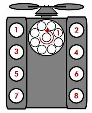

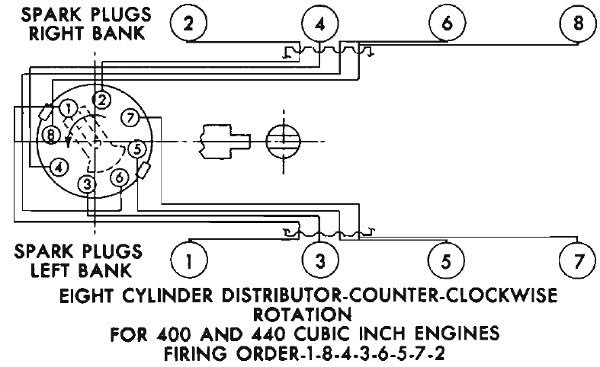

Any time I had a distributor that didn't want to drop in where it was suppose to be, I would either take a long screw driver and turn the oil pump in the direction it needed to be. Also, I have just bumped the engine over, with some down pressure on the distributor, until it dropped in. Then find TDC to check the rotors location.

Almost funny. Way I was told on any BB Mopar, was the rotor points at #1 cylinder. That would put #6, as #1 (in the drawing).
