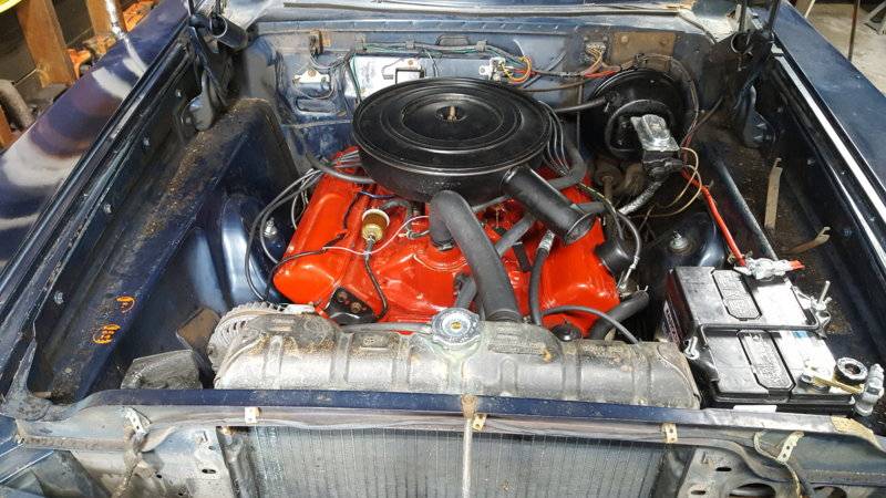

I have a rebuilt 318 poly with a 2 barrel.
MSD ready to run with an MSD coil.
Electronic voltage regulator.
Runs fantastic.

@HALIFAXHOPS can help you with those needed parts. Nice looking Poly!

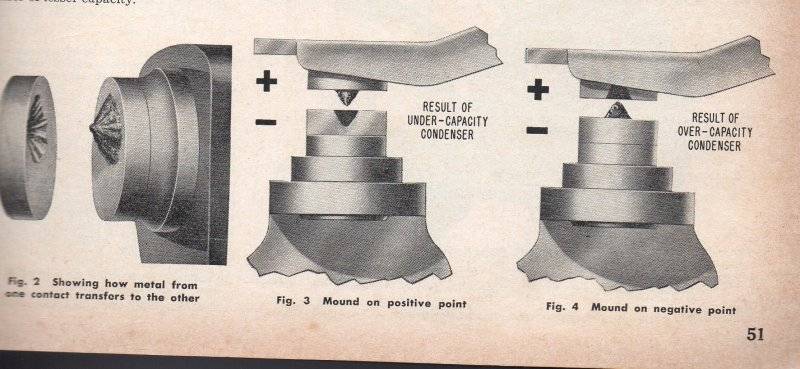

Points condensers are usually 0.25 micro farad, not higher. Using a larger [ mfd ] capacitor will result in an erosion hole being formed in the breaker arm point.....& a corresponding build up of metal on the fixed point. Timing will also change because the actual contact point has changed.
Usually....but not necessarily.....the size of the condenser (in mfd) is determined by the inductive reactance and capacitive reactance of the coil's primary windings. The larger the condenser (in microfarads) will actually improve point life by absorbing the induced voltage that occurs when the points open, during the ignition cycle........

And..
Once again, undocumented and totally meaningless interpretation.......the pictures have nothing to do with the subject......show us your calculations for the capacitor differences and how it it affects point life. BTW the picture was from the Briggs and Stratton three hp engine manual......highly unimpressive.......
BOB RENTON
We will have to call you 'Ignorant Bob'.
Not from B & S. From Motor's Auto Repair Manual, 1966, page 51. The Editor is an SAE member, & muuuuuch smarter than you are.
