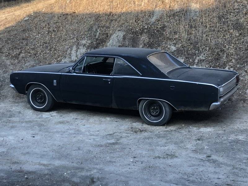

I have had points in this car since I've owned it...
Just like Renton, nothing but the best for our cars!
Kidding. I convert most everything to electronic. I just haven't gotten around to doing the conversion yet. I have everything to make the switch.
