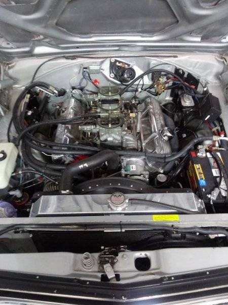

my engine
How long have you had it? I wanted one of those since the model 2 versions I had in several cars 20 years ago worked great. I was talked out if it because the rebuilder said he’d seen many failures with the fancier models. My car is all stock so the model 1 has been fine, but I do wonder if I left any high rpm power on the table. My Edison on going with petronix at all was due to the stock underhood look. I even have a bypassed ballast so youd be pressed to even notice at a glance things have been swapped.
I have had it for 3 years and only had 1 issue and happy to say Pertronix stands behind their products, I like the under the hood look also so I left the Ballast resister and box on the fire wall but they are not functional.
