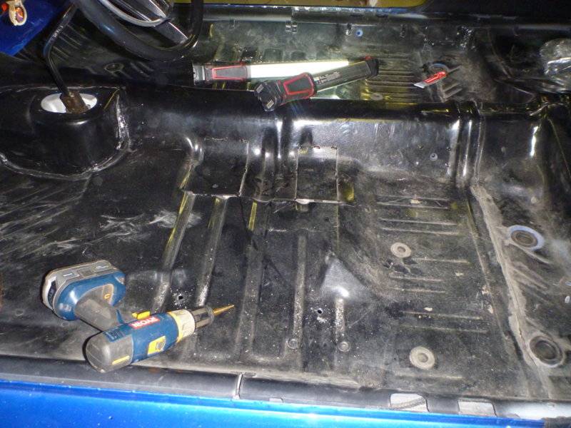

Believe the front buckets utilize the two outside holes from the bench and then the inside holes will need to be drilled. I know on the A body, they had reinforcements that went on the floor for the bucket seat studs, but I am unsure what the B body did.
There are dimples in floor where the inner seat track bolts in. Drill out the dimples and weld in the floor braces that go there for the bucket seats.
I suspected that. I'm aware of the braces too. I don't weld. There are some threads that talk about reinforcing with steel plates bolted thru.
I didn't pay any attention to my OE when it went into the scrap dumpster, but the AMD repro came with the bucket braces already on the pan... did you look under your seat? Other than that, the buckets use the existing pan holes outboard and new holes to be drilled beside the hump for the inboards.
I haven't pulled out the bench seat yet or looked under the carpet. Was just trying to plan ahead. Thanks for the pic though.
