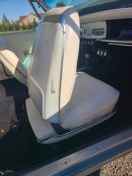

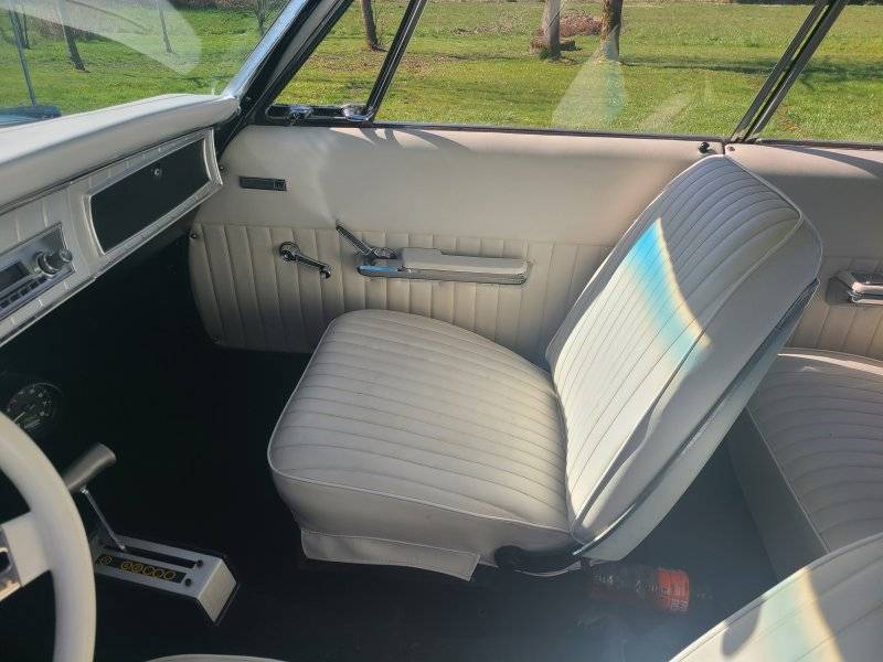

I got the 65 out yesterday to get it ready for the season. I've been wondering what the heretige of the interior is. I haven't seen this style rear bench in a Coronet. I'm thinking 66 or 67 Satellite but have seen it in other models also. I put that Coronet fender emblem there to fill the center space and cover some of the holes from the original badge which was missing.
The front driver's side bucket is sitting on a piece of 2x2 on the outside rail and is not adjustable (found a window crank knob under there too). The inside rail is bolted to the floor. It's a little too far back for my stubby legs. The passenger bucket is on both rails and adjusts.
Does anyone have a clue? Am I missing part of the seat rail? I sure appreciate you guys!

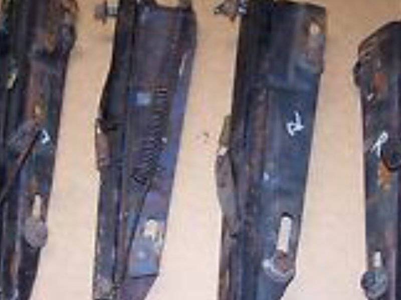

The seat tracks are 1967 b body only, 66 are adjustable.
Seat backs and rear seat & top panel is 66-67 satellite/ GTX.
The upholstery is custom/aftermarket
Seat covers are a knock off of a 67 coronet/ charger
Seat backs and rear seat top panel is 66-67 satellite/ GTX.
That confirms what I thought about the rear seat and upholstery. Just to be clear, the passenger seat does adjust and only the driver's side is on wood.
The 66s were 6 way adjustable up/down etc
By adjustable I mean the tracks are two pieces and can be adjusted on the tilt or height with bolts going sideways. You use wrenches for this, not the spring loaded forward and back like most seats have
With this info I'm thinking my fix is to get the proper 65 B-body driver's seat rail and bolt my seat to it. Is there any reason this seat wouldn't bolt to a 65 rail?
62-65 seats are different than 66-67.
