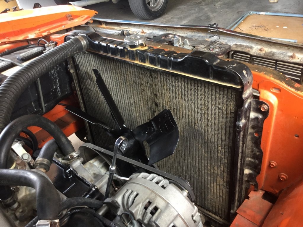

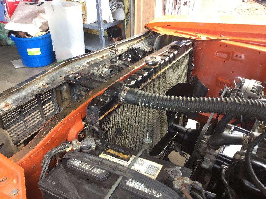

I was just wondering if this was the correct radiator for my 318 '71 charger?
That looks like an aftermarket radiator with stock mounting brackets attached. Stock radiator should be straight across the top, not with the bumps where the hose connects. If there are no Chrysler part numbers on the top tank, its aftermarket.
