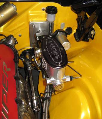

Here's a HydroBooster, running one on my 65 Satellite (No that's not my car) what I love about the Hydro VS Vacuum is you don't have to worry about Vacuum Since it runs off of the power steering pump, so you can run the thumper cams with out worrying about vacuum, IMO most of the boosters on the market are Junk anyway, if I did run a Vacuum Booster I'd rebuild the factory Booster, and good ones aren't cheep
