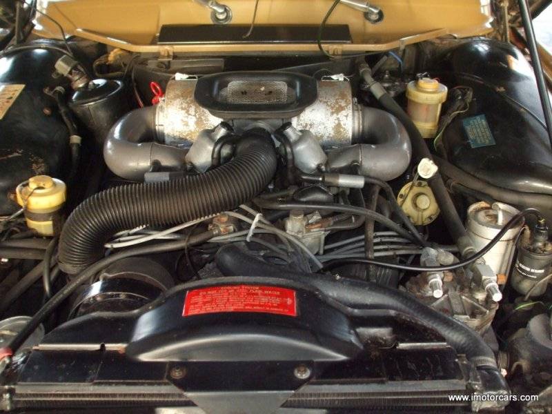

My 70 Rover 3500S (Buick 215 V8) had 2 SU carbs, feeding opposite sides, a minor ram effect. Originally, it used the standard GM mechanical pump, but suffered frequent vapor lock...even in Blighty! So...the export V8s came with an in-tank electric pump. If the car sat for days, I wold turn the key, listen to the pump until the pulses slowed down, indicating full bowls, then start. Better, Rover worried so much that the US exports had the splendid 3 cast aluminium scoops on the aluminium bonnet: 2 to cool in summer, and the center to open on full throttle to feed cool air to the carbs. Otherwise they received warm air, to help comply with smog regs. Photos to better explain, for your viewing pleasure.
Rover experts will note the engine photo is from a later SD1, confusingly named the 3500S, with the same engine. The US import version of the SD-1 had Bosch FI, to comply with CA smog standards. 8.5: CR, a real dog. Great car tho'!
