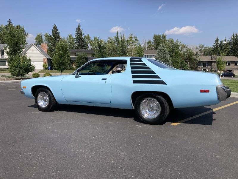

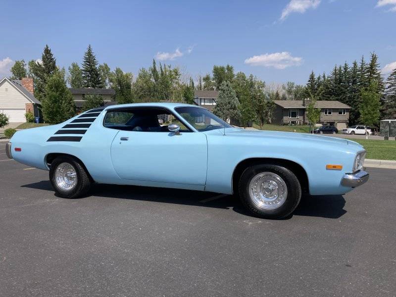

It’s not a 74 and it’s not his but here’s a satellite. Now it’s not a worthless thread. Lol
