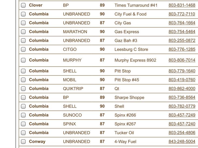

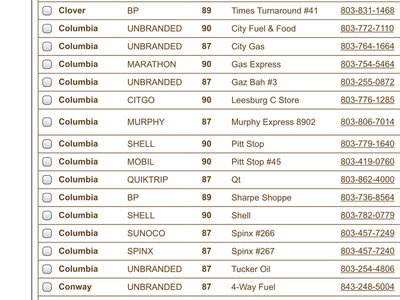

Also check your local Farmers Co-Op if you have one. Ours around here sell 93 non ethanol.
