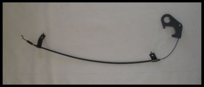

Hey guys. Just about to reupholster the last two items for my interior-the front seat backs-and I noticed that the cables that act on the seat lock lever don't move enough to disengage the lock to allow the seatback to lean forward. I messed with one cable by repositioning the brackets and clipping the end, but there appears to be way too much slop in the other one that I could 'adjust' out. I'm sure that others have had this problem and if anyone knows of a solution or alternative, it would be appreciated. I checked the usual sources and only found this one on eBay:
The seat is a split bench with the center armrest for a 1970 GTX.
Thanks
Push come to shove you could tie a knot in it between the bracket and the hold down. That'll shorten it up for sure.
Hard to tell, solid or wrapped type of cable? If its a wrapped type maybe a bicycle cable in similiar diameter would work? If its solid type maybe converting a heater control cable would do the trick. just some ideas..
Its a spring steel cable wrapped with a metal jacket that looks like a spring. I don't think that I have enough slack to tie a knot in it.
I do not believe that cable is being re-made.
do a search at salvage yards.
There has to be thousands of them out there....
