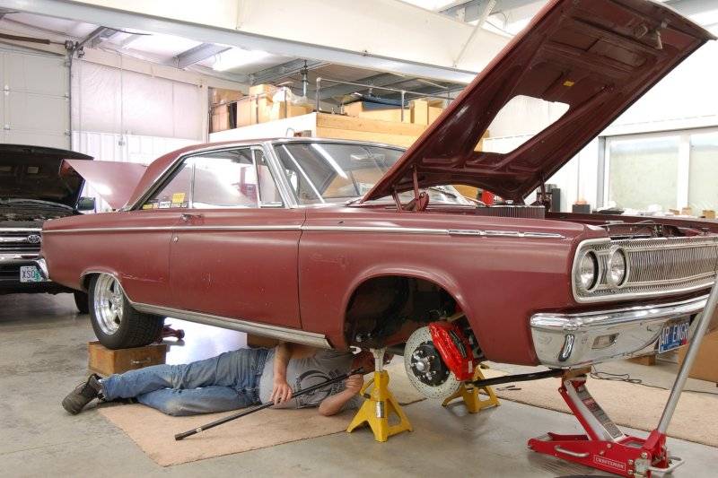

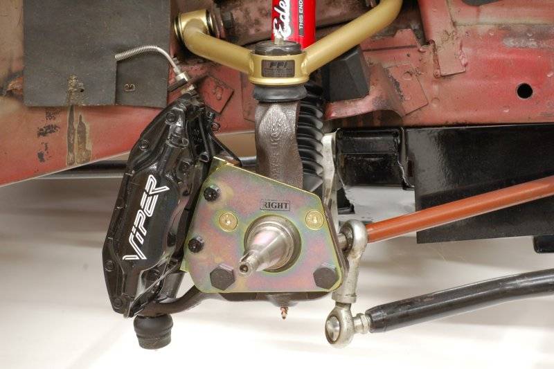

I switched to Porsche "Big Reds" for my Coronet build. The Big Reds used to be very easy to find since they were a super popular swap for many years onto a lot of different cars. The Porsche calipers are very similar to the Viper calipers. Both are made by Brembo and the specs are fairly close.

They can, depends on the make and model and year. The late model drum brakes used the same spindle as the disc brakes. In fact, I used to sell a Viper based disc conversion kit that was based on a drum brake knuckle.
I'm working on a 72 Charger.
What car is in your picture? I can't say I've ever seen a sway bar tie into a strut bar before!
