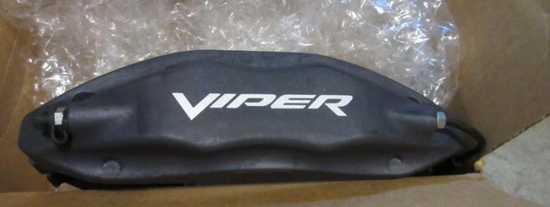

My first Viper caliper has arrived -
O'Reilly's could not get the rebuild calipers they advertise on their website. I got on eBay and found a pair of OEM calipers. Pricey compared to the Cobra calipers, but mmmmm . . . Viper logo. That said, I'd prefer these be gloss black with a gold logo. O'Reilly's phantom calipers would have been gloss black, with no logo, but I found a high temp vinyl Viper decal in gold. I thought, heck, if brake caliper decals are possible, that's probably how Chrysler did it. I'm surprised to see the logo is actually painted on.
These things are frickin' huge too. I did not expect them to be this big! I don't recall the two piston calipers on my Silverado being this big - maybe they are and I've forgotten. I bet these are bigger though.
So, these are 4 piston calipers, but they have opposing pistons, and IIRC Andy Finkbeiner's book says to measure the piston cylinder area by the pistons on one side of the caliper, in this situation, not all four. By my math, the Viper front calipers have a piston area of 4.29"s vs 4.0"s for the Cobra calipers.
The Eldorado rear calipers I currently have, have a single piston, but an area of 3.46 inches. I believe the rotor is 11". There are no performance pads for that caliper, so, although the piston area is larger than half the piston area of the Viper calipers, maybe the non-performance pads and lesser leverage will get me close to the 2:1 brake bias? I don't currently have a proportioning valve, and the distribution block is the drum brake block. The master cylinder is Doctor Diff's aluminum unit, without a booster. I'm assuming it will be possible to add the booster later, if needed. I've read that driving purists prefer the feel of manual brakes, and yet the Viper at least had the option of power brakes.

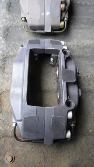

The driver's side caliper has arrived, and now I've got a decision to make -

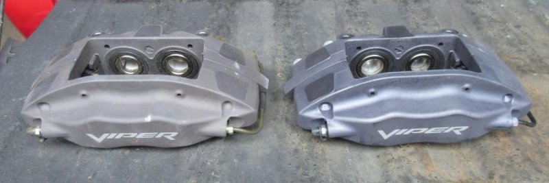

As you can see, the colors don't match. The dullest one even has silver overspray on it from the logo.
They appear to be the same side caliper -
The only way to tell the difference is by the size of the pistons. Otherwise, they look like the same part.
Here's the problem I'm faced with. I can install them as-is, and 99.9% of the people out there will not notice, or care about the paint issue.
Or, I can have them repainted gloss black so they match, and put this pretty gold sticker on -
Maybe a mask could be made from the sticker, and the logo could be painted gold, and cleared over?
Just more time, money, and trouble to get what I really want.
What issues could there be in disassembling and reassembling these calipers?
It'd be super sweet if they both had the matching gold finish fasteners and brake line too.
Two size pistons? One caliper will grab quicker than the other.
LOL, each caliper has two different size pistons. It looks like the bigger one goes to the rear and bites first, than the little piston eats its leftovers.

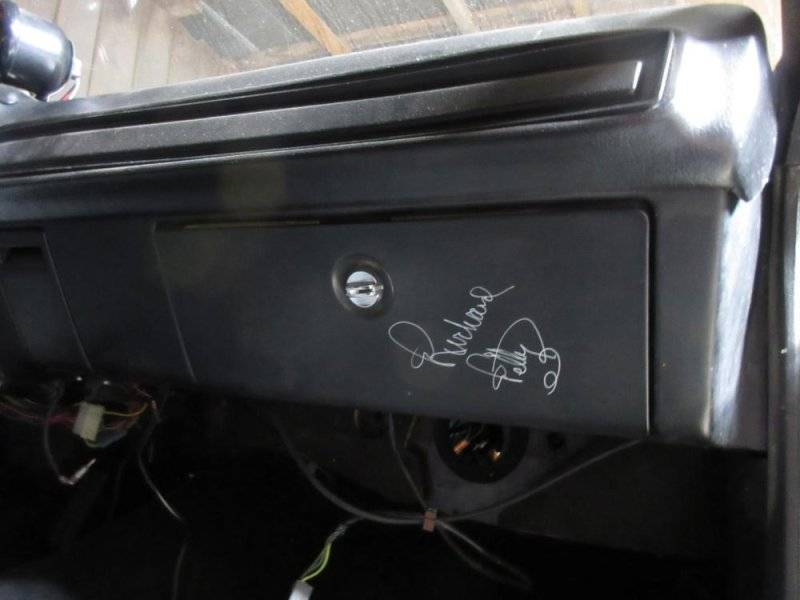

And I've got his signature on my glovebox -

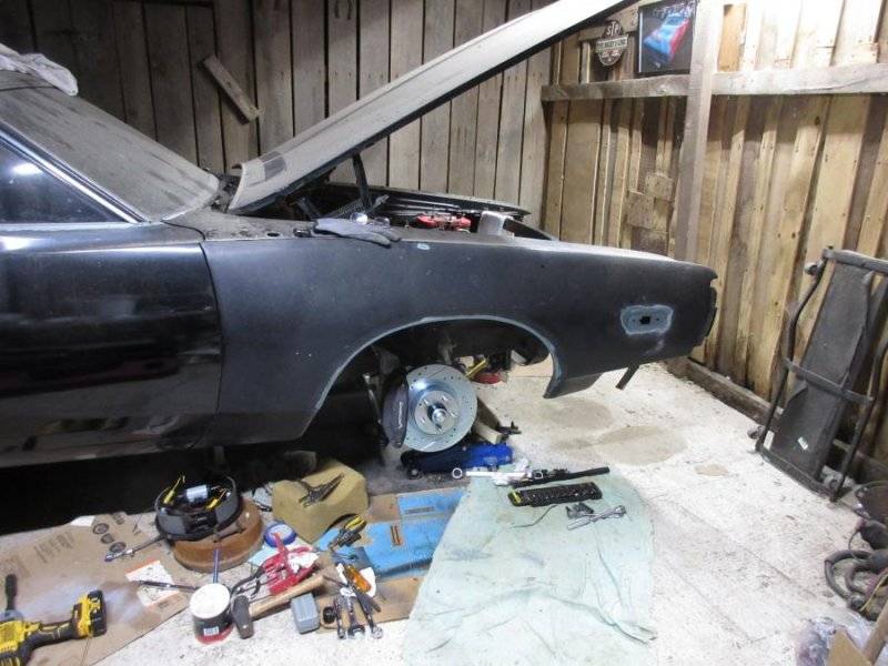

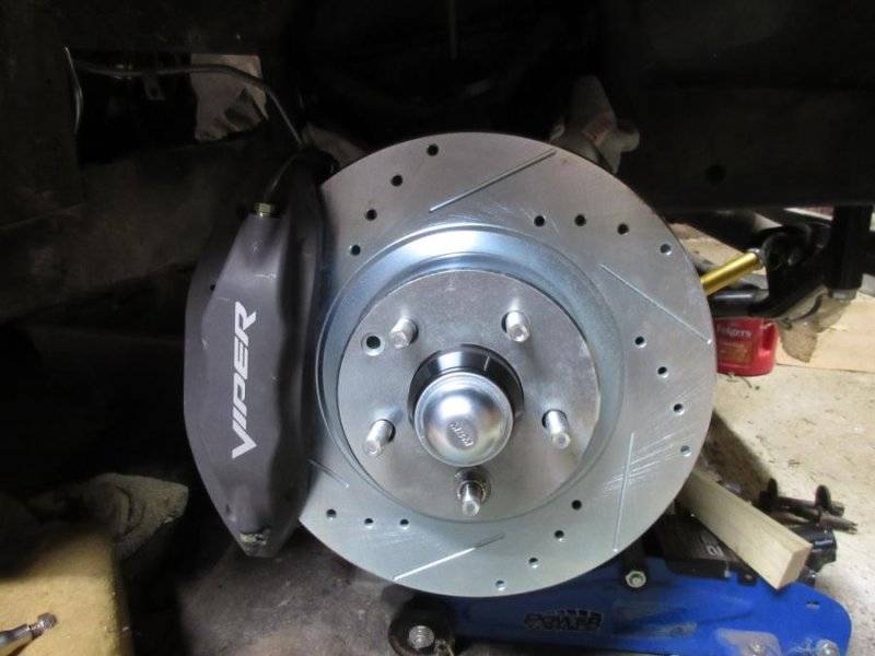

Been hitting the car shows lately, got inspired to leave the house repairs for a moment and do some Charger work. So here's all the crazy aftermarket front end stuff, trying to play nicely together -
SWEEEEET! Now that looks like the way it should be!

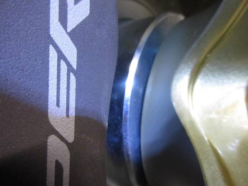

The 13" Viper disc is so big, it almost looks like a rim. It's almost as big as my 14" slotted mags. The 18's only clear the Viper caliper by a 1/2" at most. I was thinking I might be able to get a taller adapter bracket made and run a 14" rotor and the ACR-E 6 piston calipers in front, and move this stuff to the back; but I'd have to go up to a 19" rim.
The Viper brake kit is compatible with the 2" drop spindles. It would be nice to have splash shields, I don't know why they're not compatible with the drop spindle. Maybe one day I'll buy a set and see.

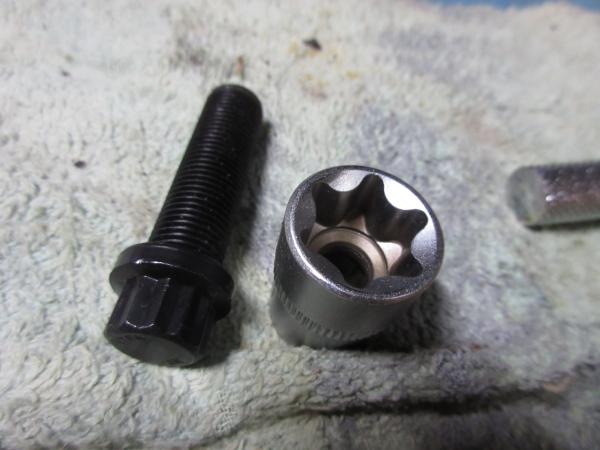

If you buy the Dr. Diff 13" Viper brake kit, be sure to have this tool, or you will be a sad camper until you get it.

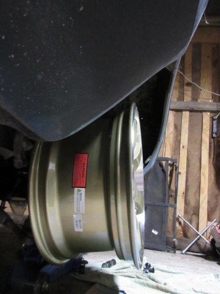

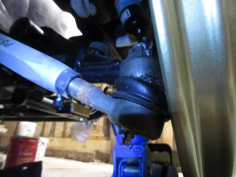

Moving on to rims - unfortunately that did not go as well.
I read that there was potential for interference between the knuckle arm and the rim, when using a wide rim and a drop spindle, and there it is.
The fitment guys aren't going to like seeing the rim so far inside the fender, but there's little danger of the tire rubbing on the outside.

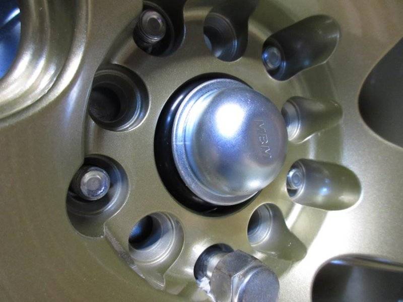

I guess I've got no choice but to use a 1/2" spacer here. This is as far as the rim is going to go on, thanks to the silly lip on the center hole of the rim.
Gonna need longer studs for sure, and different lug nuts.
I saw a guy at the car show today who had a Datsun 240Z on aftermarket rims. He had this same problem with the dust cap sticking through his rim. He ran it like this - exposed dust cap, no center cap. I guess that's one option.
