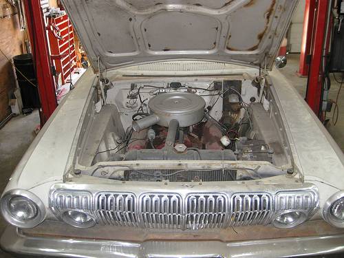

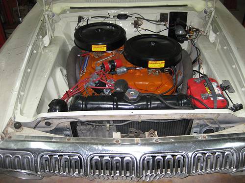

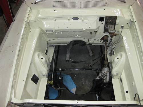

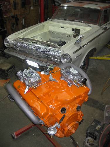

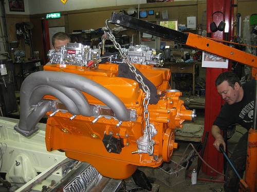

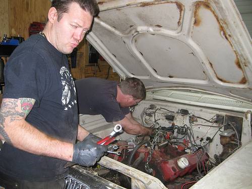

It was a long winter without much progress but in the last few weeks things have really come together.
Big thanks to 'Dangerous' Chris Carlson and Polara Pat for all their help.

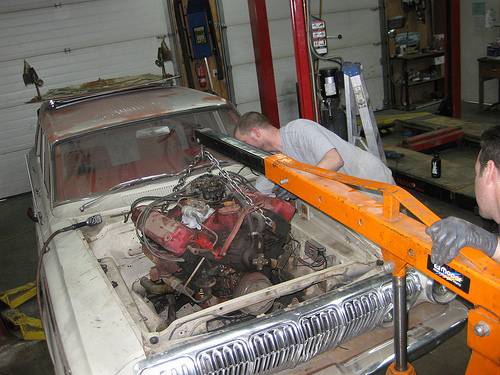

Managed to get the motor off the stand and into the car. Just had our Muffler guy, Mode, put the exhaust system together and now there is some fine tuning to be done. Now to tackle the body work......
From this...
IMG_2360 by 63wagon, on Flickr
IMG_2364 by 63wagon, on Flickr
IMG_2370 by 63wagon, on Flickr
IMG_2379 by 63wagon, on Flickr
IMG_2380 by 63wagon, on Flickr
IMG_2386 by L63wagon, on Flickr
IMG_2389 by 63wagon, on Flickr

I love the cross ram sandwich tray. I have so much engine envy it's ridiculous. It's been fun building it vicariously through and look forward to our two wagons battling it out at the track.
wow that looks like great work you are doing there! what are the specs on the engine and what HP do you think it will have?
Awesome wagon !!!!
How many neddies is that monster pushing out???
Look forward to more of your updates.....
Cheers !!!
Wow that looks good ! Ron
as for specs:
413 bored .40 over
Balanced RA
forged flat top Speed Pro Pistons
10:1 compression
.500" + lift Hughes
roller rocker 1.6:1
600 cfm edelbrocks
Repro MW intake from A&A
Repro MW exhaust manifolds from Mancini
'65 727 BUILT BY Mark Maez(wagons of Steel)
2500 converter
looking to make 450 + HP
Good Times...heading down to the local pub for another road test

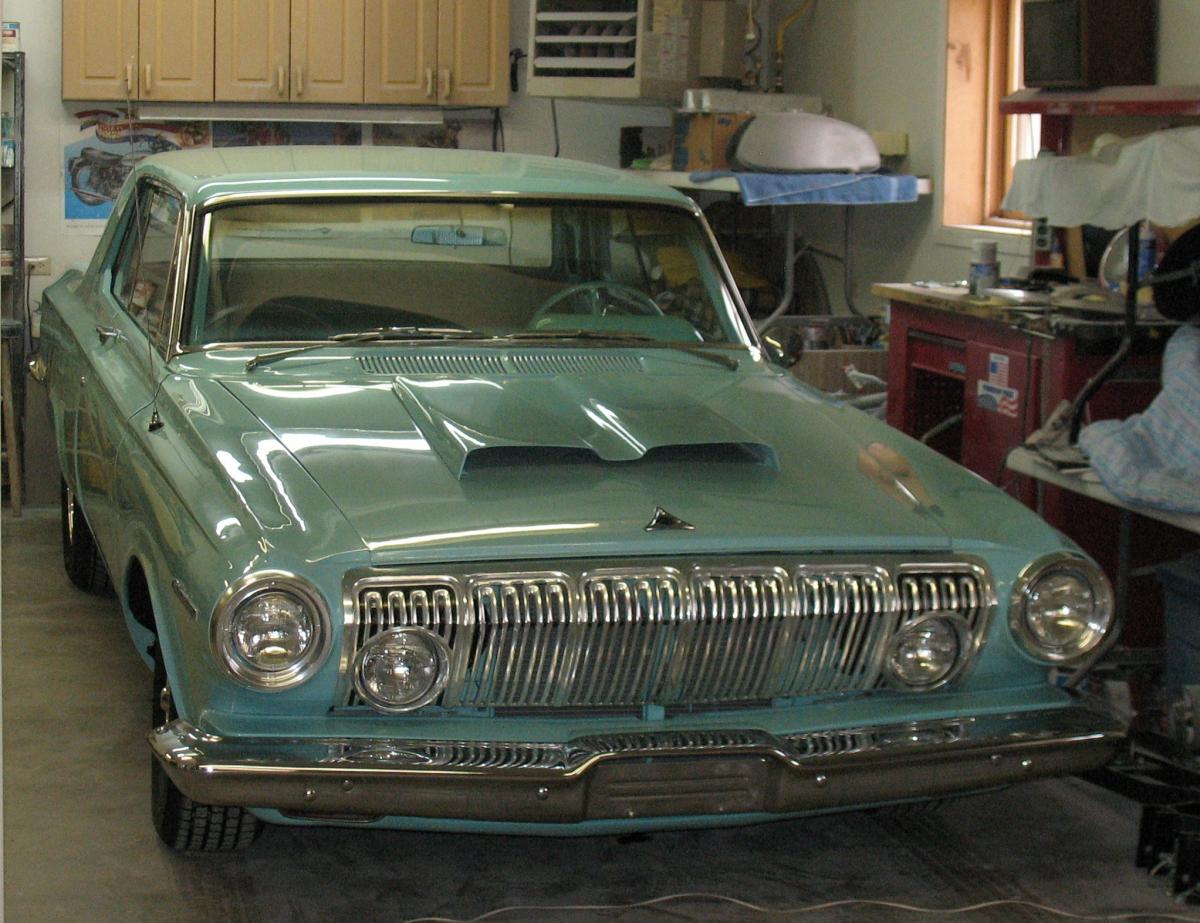

Polara tow rig. by 63wagon, on Flickr
