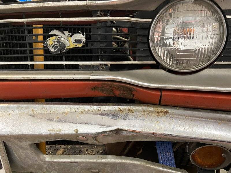

    Since you guys are able to help so easily, here’s another “issue” I’ll have to correct.
    The car was towed to the track by the front bumper. It caused damage to the metal strip above the bumper and below the grille.
    I have no clue what this part is called and haven’t found any listing for it anywhere.

      3rd try to attach a pic…

          The piece between the bumper & grill is called a filler panel, none on Ebay right now, they don't reproduce it but they do pop up for sale pretty regularly, I have one for a 68 but 69 is different..

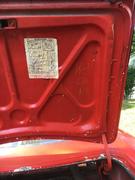

          A12's didn't come with any option for a wing so that's not original.... Depending on how it was installed you might want to look for a trunk lid.... If it's just two small holes they can be welded shut but sometimes the metal gets severely stretched...

            I know it wasn’t original. From the mounting holes, it looks like it was a Mopar “Go Wing”.
            If the pic uploads, you can see the holes and why I wish the trunk lid could be saved. I assume those are factory assembly line markings in yellow.

            Looks like the damage isn't to bad, hopefully it can be saved... But to weld the holes up the paint will get cooked... Might have to just find some blanking plugs, paint them to match & live with it...

            Or put a go-wing back on it!

            Yes, this is a factory marking indicating the tire size for the car. There are several different ones for A12 cars.
