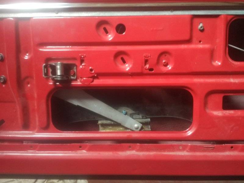

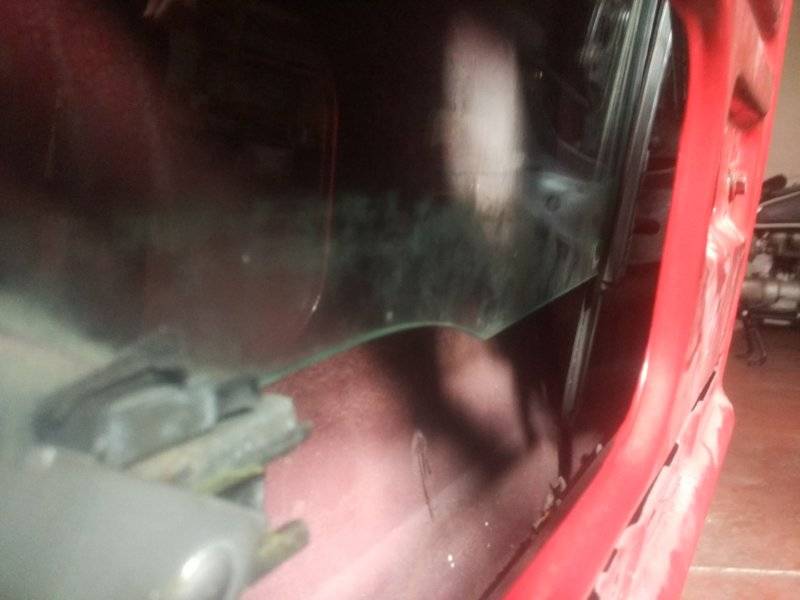

First I was wondering if I´m missing any part on the window mecnism on the car because the window in question goes up but it doesn't go up straight. The window has a hole on the botom right corner (photos uploded below) and I don't know if it's missing something.

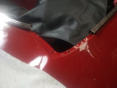

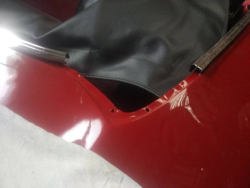

Also I got the trim for the convertible top of the car but I'm missing the corners.

1. Convertible trim at body/top
a. The trim corners are available in the USA as reproductions. I also have those parts for sale, but mine need to be re-chromed.
b. You have the back/passenger piece of trim backwards. All the trim fits along the curves of the body.
2. Door window
a. It looks like you have all the parts.
b. You probably need to adjust the rear window guide (inside door, next to glass, has rubber inside, at back of glass).
c. You might want to replace the rubber on the front of the glass (inside the "run channel" which is the back support of the vent window) + the rubber in the rear window guide.
