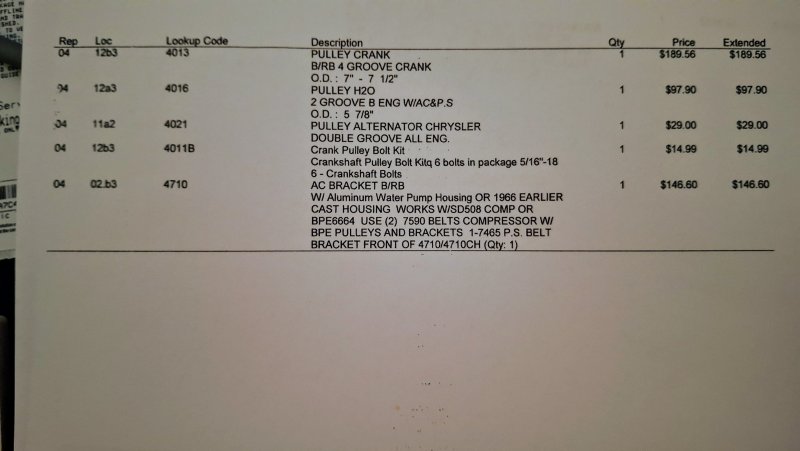

I wonder if there FlowKooler is flowing too fast nit allowing enough time for a thorough heat transfer. I may try swapping it for the 6 fin stock water pump for AC to match the factory AC pulley size.
According to Bouchillon Performance Engineering, the crank pulley is 7-7.5 inches in diameter and the water pump pulley is 5.875 inches for the proper drive ratio.
