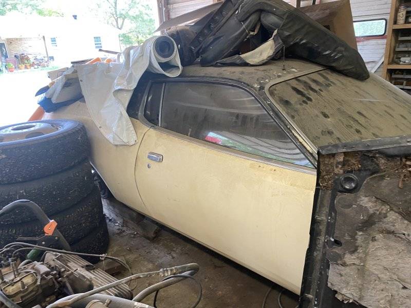

I have a 1972 charger se that has a seemingly modified engine, it looks like a 360 or 318( the chargers original engine was a 318) but I don’t know if it has been transformed into a 390, does anybody know how I could find out. I don’t have a picture of the full engine but these pictures have part of it

Seemingly modified? Why do you say that? A 4 barrel and valve covers is what I see in your last photo. The block size is cast into the side and like the fellas mentioned, you will have to disassemble and measure the rest. In general terms, a 390 is a 4" stroked 318 and a 408 is a 4" stroked 360.

The pix of the engine with the valve cover and carb shown....the carb that's visable, appears to be a Carter THERMOQUAD. I believe they were std on certain flavors of Mopar 360 and 340 engines.....possibly police option??....likely a 360.....

Could be, It could be any LA. The OP said the Charger was originally a 318. It would have came with a 2 barrel. Everybody wanted a 4 barrel on their Teen. A lot can happen in 50 years.
There are cast in numbers on the side of the block....can't remember what side but they are prominent. There's also stamped numbers on the driver side of the block just below the head gasket parting surface. They are usually faint but cleaning that area of the grime (if any) really good, they should show up. If it's already clean and still can see them, sand the paint and they will appear.
