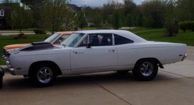

I dont get much traction on the street either. The street is nothing like a treated track. I drive on my Hoosier radial slicks that are 30 x 9 and I can fry them on the street. I use just SS springs and the long MP shocks. But at the track after a small burnout it hooks fine. Its pulled a 1.50 best 60 but hooked so consistent last time out in Oct I ran 10.76 three passes in a row. But really I dont get any traction on the street either. Here is how mine sits. Ron
