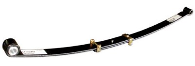

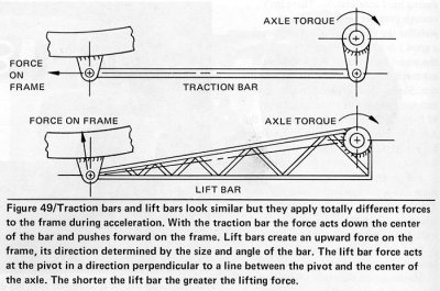

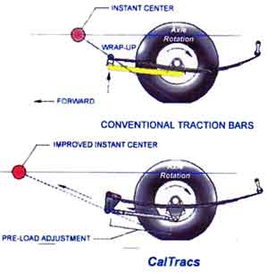

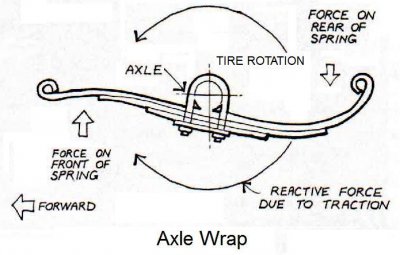

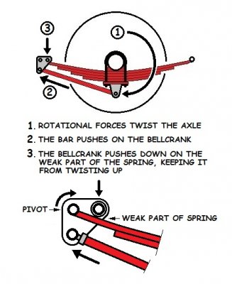

CalTracs not sure about your homemade jobs, they recommend that your NOT supposed be to used with S/S springs, the S/S spring alone or a different style leaf would maybe be better you have the 2 traction aids just fighting against each other maybe... the rear section of the S/S springs are made to lift, possibly counteracting what your home made traction bars, are doing keep the S/S springs from working properly... run one or the other not both... You possibly go to the Calvert CalTracs site & read about how they work, if yours are a copy... do you have the front pivots on your bars too ??, really part of why the CalTracs work, my old car could bite most anywhere with CalTracs... I'll use them again on my current project too.... just curious, not sure any of what I said could/would help... not really knowing your rear suspension set-up...

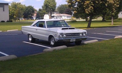

Your car has a bit of rake to it, doesn't it? Raising the front or lowering the rear might help more than you think. Find the corner weights and adjust height to see its effects...
Not too much rake.... 15" wheels front and back....
Budnicks,

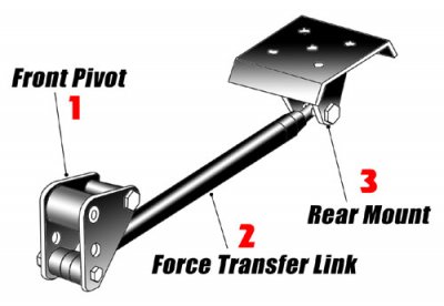

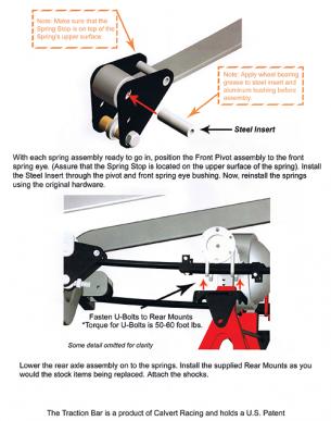

My homemade Rip off (CalTrac) is setup just like purchased items... They pivot at the top, and have two points for the link bar. The link bar has Chromoly threaded ends "LH & RH" so you just loosen the jamb nut and twist the tube to increase or decrease pre-load.
I think springs act the same regardless of the number of springs as far as how the rear end torques / twists them. S/S or not, they want to twist the same direction... this is an act of the housing, not the spring.... I could be all wet on that last statement,,, but I don't think so...
I was having traction issues before I put the traction bars on too.... I think wind up has been eliminated as a result, because if you back them off so you have a gap between the piece that goes over the spring, and the spring itself,,,, you can hear them smack when you hit the gas... With them adjusted down to just off the spring, the wind up smack goes away under throttle...
If I had the Extra coin,,, I would just purchase a complete setup with mono's and rear sliders to free it all up.... I just keep thinking that I'm missing something else BIG TIME with it as is!!!

They are fighting against eachother. Swap to a mono leaf or take the caltracs off. Also, try lowering the front end, when I lowered the front of the Belvedere there was about 2 inches of play (I could lift the front end 2 inches by myself before the actual car weight was being lifted). It throws more weight to the back wheels off the launch.

Ryguy, could you elaborate on how they work against each other please? What happens that they work against one another mechanicaly?
Car have anti-squat? Can you tune a/s w/ the bars you made? W/ Calverts it appears you would just add preload...
You can tune them like Calverts.... It does prevent axle wrap too.... As I stated above,,, you can hear them smack the top of the springs if they are adjusted an inch or so away and you hit the go pedal...... With them down to just off the spring, you don't hear the smack, because they engage right away and shove down on the top of the front spring segment..... Seems to me like they are doing what is supposed to be happening with this design.... They allow the rear to go up and down but eliminate axle wrap which can produce spinning when the axle snaps back from the wrapped position.... Seems to make sense to me anyhow...
I'll also note again that the wheels spun like hell BEFORE I added the bars.... These haven't caused the problem,,, and I "Believe" the theory is sound in that it does prevent axle wrap, which can ONLY lead to trouble when they spring back....

IMO, that's a lot of rake. Scale the car at that height then lower the rear even with the front and see how much difference it makes. I think you'll be more than surprised at the difference.
Looks like I'll be on the hunt for some barn scales...... This is taking me back to the Dirt Track Late Model days!!!... LOL!!!! I thought I was done with weight jacks, and re-curving the springs!!
