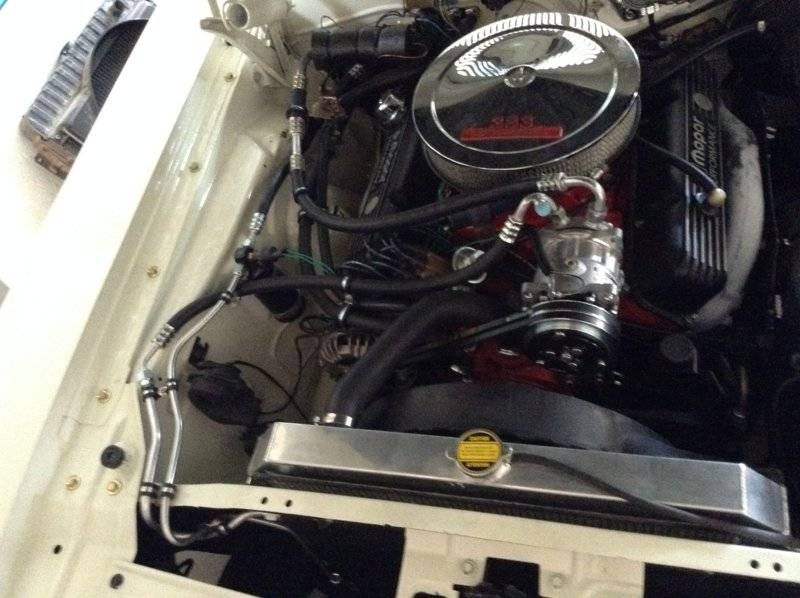

These kits that are offered by companies like vintage air and alike do have all of the items that are needed to complete an AC system install.
I was on a tight budget and so I tried to assemble a system for less and did. If you are not on a budget, it is easier and less complicated to just get the kit.
If you are interested in piecing a kit together, I can give you help if you ask for it, otherwise good luck.

View attachment 721918 View attachment 721919
I prefer piecing it together, otherwise your stuck with what you get. Kits are generally put together with one thing in mind "how can we make this a bolt in kit" which isn't necessarily a neat clean installation.

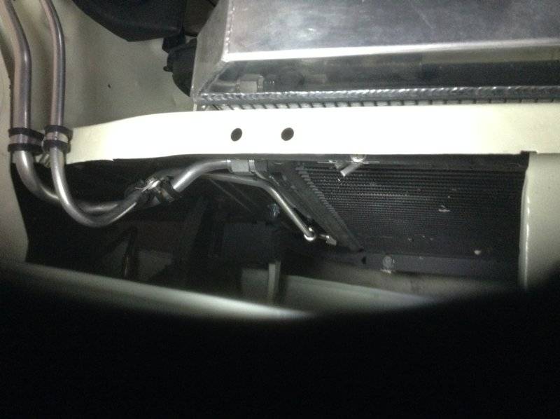

Exactly...I bought my Vintage Air system - Evaporator, pressure switch, filter, first condenser and duct with outlets. Then I went to Bouchillon for the brackets, pulleys and compressor - to make sure the compressor would work with the brackets. I then on-sold the first condenser as it restricted the small amount of airflow that my truck radiator gets...in favour of the under-body condenser complete with it's own fan and shroud.
It's not too difficult to piece together the parts, once you know what you need.
