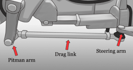

The steering drag link (side to side bar) is behind the beam axle.
Tie rod end on the passenger side.

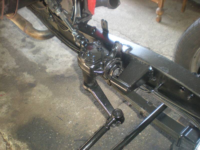

Agreed.Any front steer forward mounted box should rotate the way you want. Size and mounting it are the problems. Any 70s-86 square body Chevy has that box, same box on Dodge trucks of the same area. Drawback is they mount outside the frame and the size may not fit under the floor.

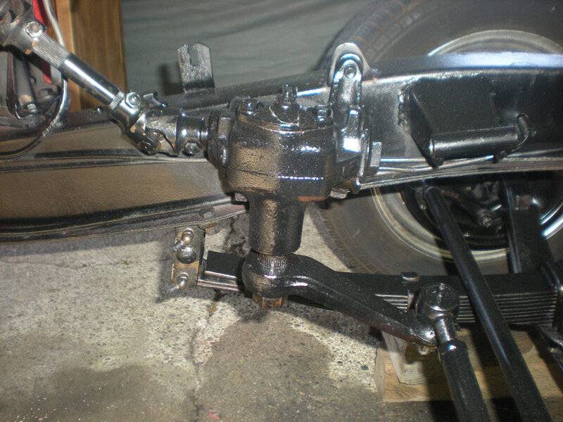

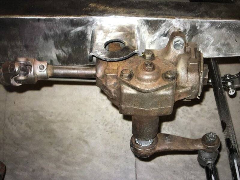

The box in the pic is manual. The power steering@Dan64 - I think I can see, but can you confirm that this steering box is manual?
Thanks.
It's not mine,I can't find any close up pictures of the one i just sold but i'm 99 percent sure it's manual, power Vega boxes are not widely used and almost never used in a small/ mid sized hot rod builds. My only experience with Vega boxes are in light weight Model A's.@Dan64 - I think I can see, but can you confirm that this steering box is manual?
Thanks.
