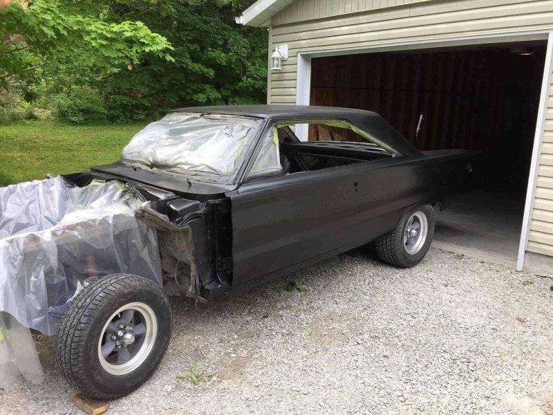

Does anyone know what size wheels/tires on this '67 GTX?
275/60/15 you'll need to roll the lips to make these fit!
On a 66/67 it’s a good idea to check the year of the rear end under the car. Both my 66 and 67 over the decades inherited rear ends out of 68-70 cars which are slightly wider width. I don’t remember how much and it’s not much - less than an inch. But it makes a difference in getting tires off and on in the rear. With 15x7 Magnums I’ve almost had to unbolt the shackles to get 235/75s pried out from under there. I’ve gone to 215/75s on my 67 and thrown out the 7” magnums altogether on my 66 rather than deal with it.
your right, at factory height it would be scrubbing when sideloaded or going into raised lots!
