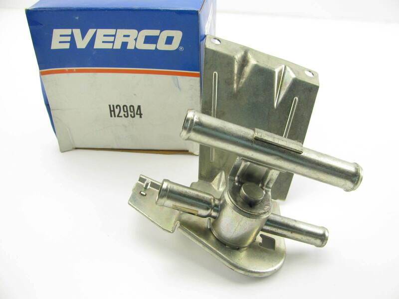

The Everco H2994 heater valve arrived. It does a 100% shut off when tested with air. It is made for 75 and later, so I expected issues. It has a slightly different mounting bolt pattern which is no big deal, but the biggie, it operates *** backwards from the 71 to 74 valve.
I am going to plumb it in and make sure it stops the hot water flow 100%. Then decide what to do.

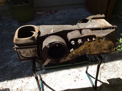

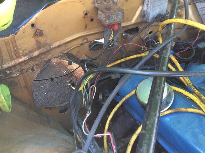

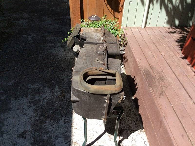

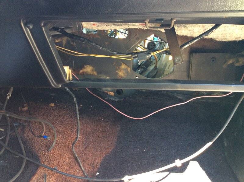

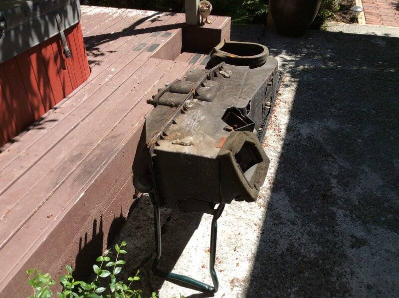

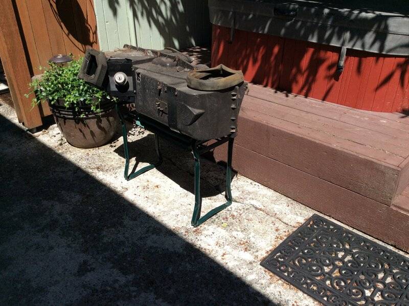

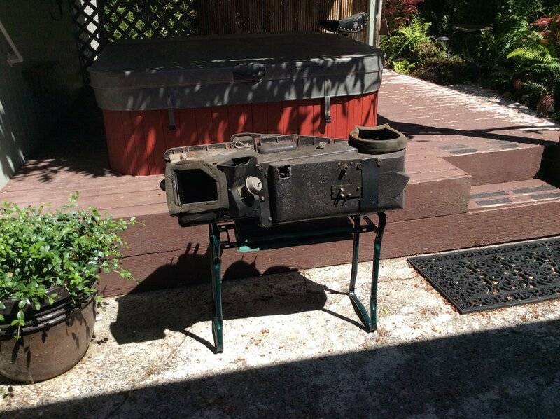

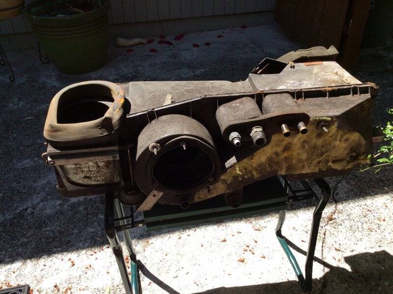

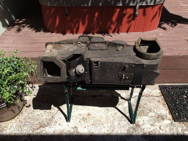

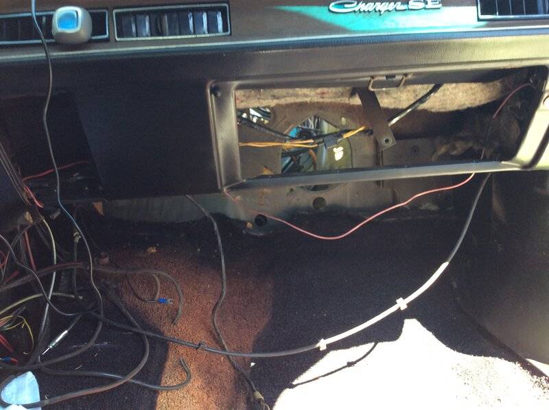

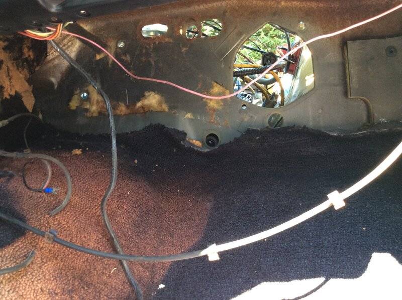

Darter6 here are some pics of the a/c heater box I took out of my Charger. You can see how much space opens up under the dash. The hot tub in the background also gives a good idea of the overall size of this unit. I will see if I can find some more pics of the install and post when I can. :thumbsup: :luvplace: :popcorn2:
:xscuseless:
2018-Heaterboxgloveboxout01.JPG 2018-Heaterboxgloveboxout02.JPG 2018-Heaterboxinsideout01.JPG 2018-Heaterboxout01.JPG 2018-Heaterboxout02.JPG 2018-Heaterboxout03.JPG 2018-Heaterboxout04.JPG 2018-Heaterfirewallout01.JPG 2018-Heaterboxout05.JPG 2018-Heaterboxout06.JPG

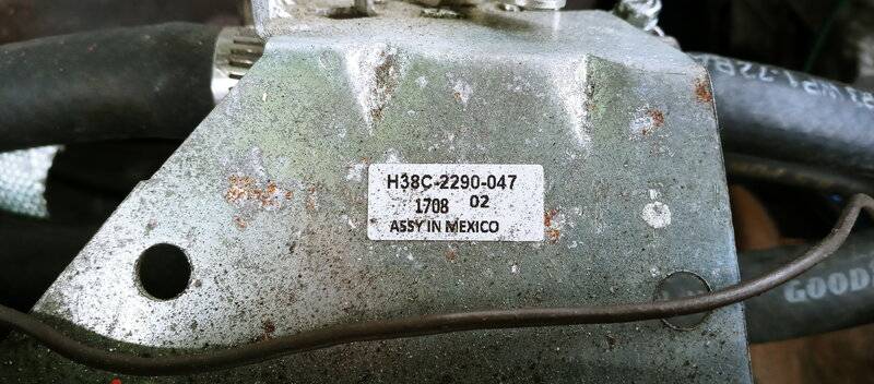

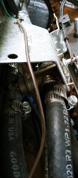

:lol: :thumbsup: I went out today and put the new wipers on and thought about this thread so I took some pictures of the heater valve and this one does have the return loop on it so coolant still circulates when it is closed to the heater core.
Hope this helps if anyone is working on this.
