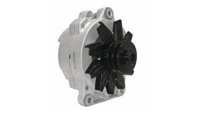

I’m getting my ac working and i’m worried my system will have issues running with the lights, ac, speakers, etc. on my 60amp alt. Has anyone used the 114 amp alternator most parts stores are selling now? Do they bolt right up and what needs to be upgraded on a stock electircal system to support that amperage?
This is the alternator.

I don't know what the alternator in the photo is? Have more info on it? Is it still externally regulated, or internal regulated.
