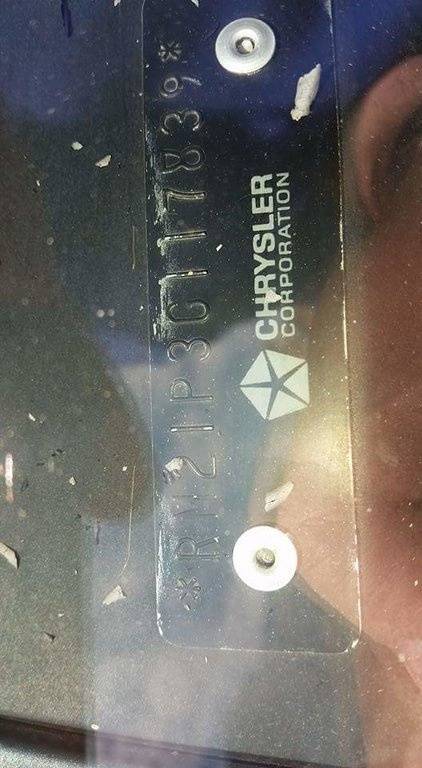

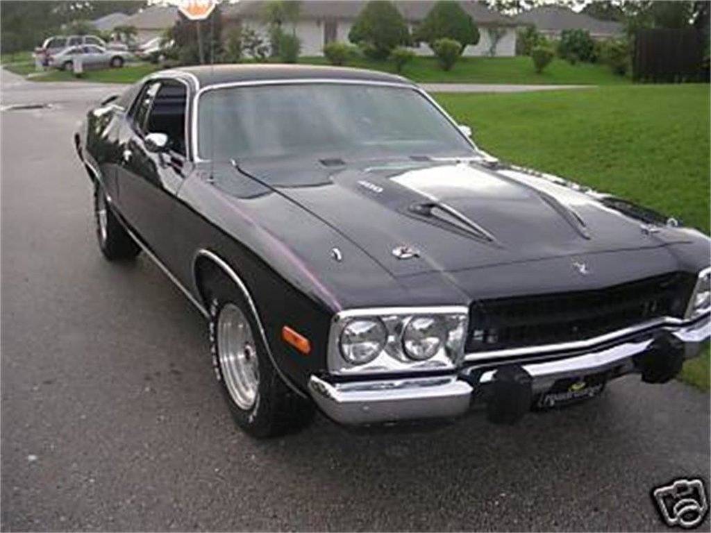

Does this look shady to you?
Lt Shaffer
10:50 AM
Mar 22, 2012
57
65
United States
Yep wrong rivets bet it doesn't match the body numbers
Bingo, waiting on reply from the seller on the body numbers. Vinyl top, chrome drip rails & wheel well arch's say RP to me. Oh and the fender tag was lost in the mail from previous owner. Vinyl topped 73's are very rare.

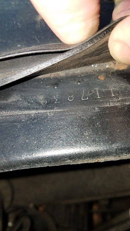

Check those last 6 sequence numbers against rad support and left trunk weatherstrip rail numbers. If they match the vin then the vin belongs to that car. Just change the rivets out $25 a pair. If the vin doesnt match those other sets of numbers then walk away from it. Rare vinyl top or not. The trunk weather strip is glued over the stamped in numbers, and the yellow antifreeze info tag covers those numbers stamped on the rad support. They did this for theft reasons starting in 1969. Just an FYI it looks like that vin tag was pried on as well as the incorrect rivets. Tread carefully.
Hope this helps
Matt
Fender tag lost in the mail? That happened to me, I was suppose to get a million dollar check!

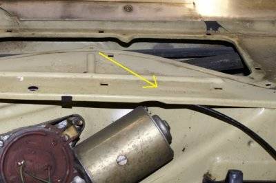

surely wrong rivets , you can get right ones from ECS . won't find numbers on trunk rail( there are none ) ,they are on the cowl slightly to the right of the brake booster under cowl seal
STRIKE 1, wrong rivets as stated. Trying to be optimistic but with the wrong rivets, usually isn't going to turn out good.
Run away is correct if the numbers don't match I'm out. I sent a long email to the fellow selling it yesterday with no reply as yet. He bought it off eBay about nine years ago. Looked real nice exterior wise at the time. Lots of mismatched interior colors though.
It is hard to tell what these cars go through in their life. Some people, (myself included) are not hung up on if things are changed on a car, and do not car if it has an incorrect radiator or this or that. However, if he is selling it as one thing and there is nothing to back that up, then that is a different case. Things do get lost, sellers find things like fender tags that were put away for safe keeping after the car is sold, but the rivets are shady and if there is no other documentation, you have to go on what is really there and what you are really wanting. There are radiator support numbers also, usually upside down that should match the cowl numbers, and maybe a door decal on the driver's side. Those can be reproduced though, but given the looks of the interior, probably did not go to the work to fake that if it really is a rebody/fake.
Not uncommon to pull the VIN while repainting the dash just sloppy to not get the right rivers. Hope the body #s match.
If all the body numbers match the vin, then just R and R the rivets. Theres a guy who sells the rivets, and a dry transfer that says chrysler corp with a pentastar. You can restore the vin tag and reinstall it with correct 1/8" rivets. Hopefully they didnt ream the holes oversized in the dash and plate up to a larger size. I mean dayum at the very least they could have painted the effing rivets black with a Qtip. If the holes are oversized you can use a washer underneath the dash with an 1/8" hole to back up the rivet. You will need long arms and a helper to do this though lol.

Well,it looks like the cowl number matches. I would have guessed it wouldn't. Last digit is hard to read but it looks like a nine. Why on earth would someone pull off the tag unless they were doing some painting which this car hasn't had.
Probably had intentions or repainting the VIN tag and dash, and lost interest. Or removed it for 'security and safety' reasons. Either way, it's sloppy to just use regular rivets to re-attach it.
