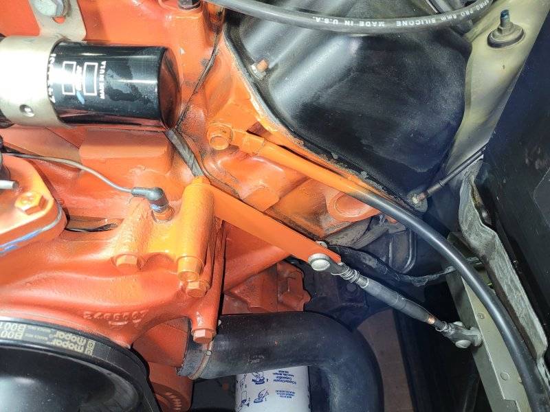

Does this torque chain look ok???

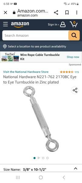

Years ago I went to the farm store and bought a aluminum turnbuckle. It looked good and worked well.

I like the turn buckle design. Made mine similar except I bolted a plate to the front of the block instead of the back of the water pump and used a sway bar link rod bushings on the bottom to provide a little cushion. It's a 512 stroker motor with tons of torque and a manual transmission that launches hard through a Strange Dana 60. It goes to the drag strip several times a year and haven't broken anything yet.

If you must use chain, and it is slack like the OP's picture......twisting the chain will shorten it and therefore become a tighter fit.

I have tightened up the chain for the time being. I will replace the mount with the bolted through mount in the near future. Thanks for all the help!
